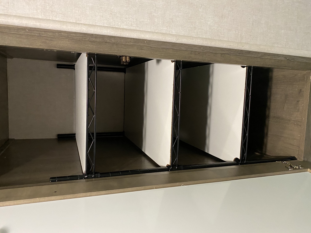

I ended up removing the piece of trim on the right inside which allowed me to build the rack inside freestanding so no wooden cleats needed. It's exactly the right size. I then had some scrap 1/4" material I used to line the shelves so clothes would be easier to slide in and out than on the wire shelf. Thanks so much for the idea and I'm glad Home Depot had them in stock!
