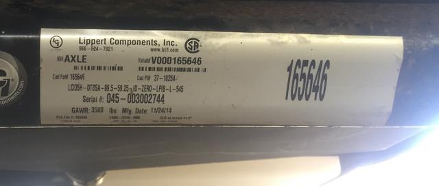

You could take a look at the part number on your axle. Assuming its a Lippert axle it should look something like mine. Its the long sequence of letters and numbers starting with LC35H:
The later ones which have what Forest River is calling the "different pitch angle" I think have a "220" where my 2015 states "zero". This number is what the axle industry calls the "start angle". These are torsion axles so the start angle is the angle that the torsion arm extending from the axle tube is set to under no load. A higher number (I think) means that the arm angles downward further under no load so increases the clearance under the trailer. The 220 (I think) implies a 22.5 degree down angle.
I'd have to go measure the length of our axle torque arms but I think they're around 6-8 inches long. If so, a 22.5 degree change in start angle should change the ride height by about 2-3 inches.

Posted: 03 Mar 2019 at 12:41pm |
boater, if you mean the axle part number, it should be on the back of the axle tube soewhere near the center.
