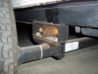

My 2016 h180 HRE (made in 2015) did not have rizers. The axel was reclocked for the larger tires. My tires looked just like your picture, On a large bump the tires hit the fender and broke the wires to the marker lights. My local Rv guy called Forrest River and they still have rizers available for $125.

Thanks for the pic, I know there are no risers on my Pod, so now with this new info I will look and see how the the torsion arms are clocked!
