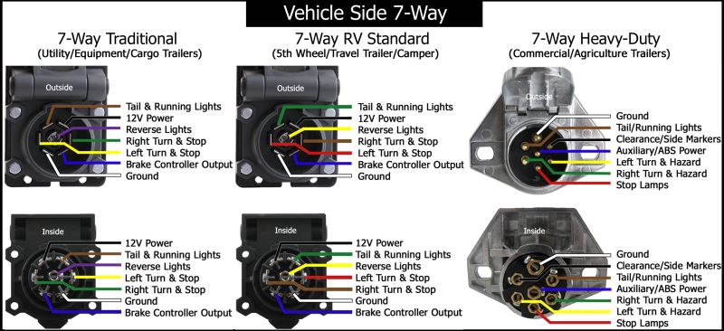

+1 to CharlieM, the converter has nothing to do with issue. It doesn't have any power minus shore power. Best to carry a pin layout of the 7 pin and a meter to verify voltages when troubleshooting. Here's a vehicle side pic from etrailer:

Note that the "Traditional" and "RV standard" pictures above are essentially the same. The only difference is the color of the wiring; the pin positions and functions are identical. A bit confusing at first glance. Thanks, Mike.

CharlieM, Yep I ignored left and right and went with RV standard, which is correct. As far as TV charging I would start at TV to see if I had voltage, before I disassembled the TT battery box. Just me, I'd split issue in middle then resolve.
