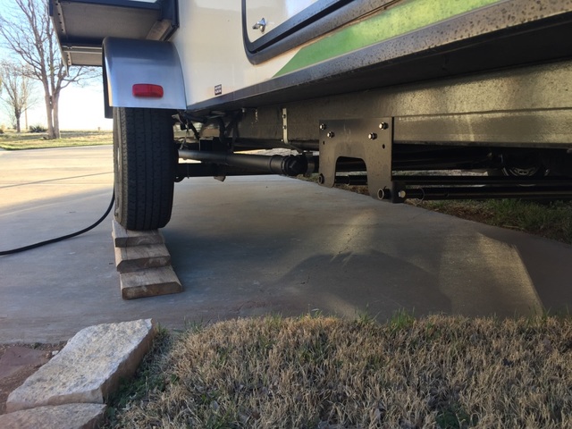

I added the lift kit.  Adds 3.5” I think.

It is a 2015 182g.  Got the kit from my dealer.  $140 I think.  I think you can order direct from forest river as well.

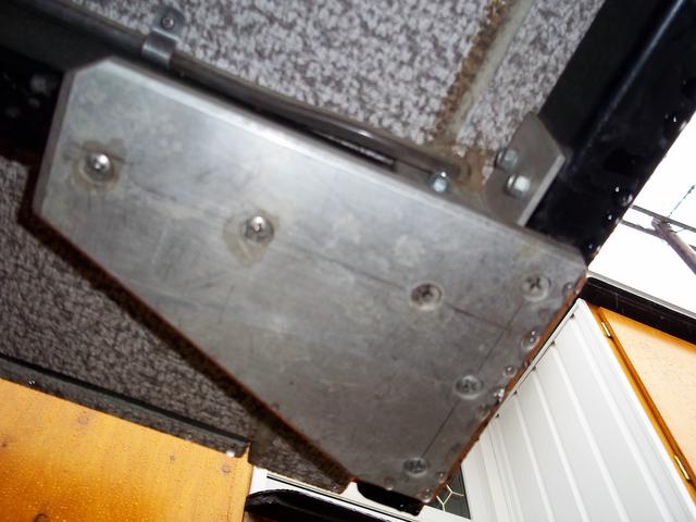

I put on some skid plates.
