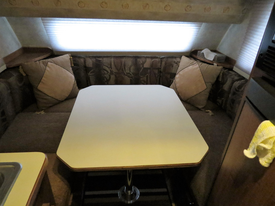

marwayne, would you mind dropping down to Dayton, NV this winter when it's too cold in the north of Canada? Last time ai was in Edmonton it was a Feb a few years back before I retired and it was way too cold. You could help me with all kinds of improvements in my 172
![]() Seriously, though, you have done some incredibly nice work. I like the drop down on the stove side of the galley. I had added one over on the other side of the sink, but I'm lazy and just used a conveniently sized cutting board. I also did the pedestal mount for the table. It sure makes getting in and out of the dinette easier.
