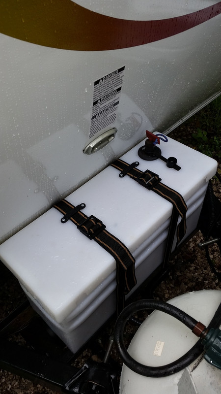

I am looking to add a battery disconnect switch to my pod but not sure where to mount it. I was maybe looking near the battery or frame near the battery. Ideas would be great...Thanks!

I put ours right on the box. I just cut out one of the box vents and mounted it through that hole. I used a HELLA brand switch not a Chinese knock off, 7 years later, the switch still works fine according to the current owners.
I used the same switch when we changed to dual GC2's..

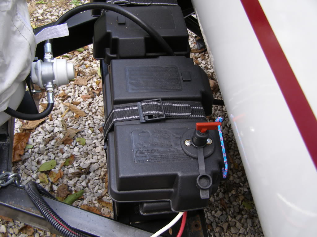

My was easy. Just put it next to the battery box on the frame and used tie straps around the frame.... Works great.

I used an outlet box, mounted on battery mounting frame , easy.
