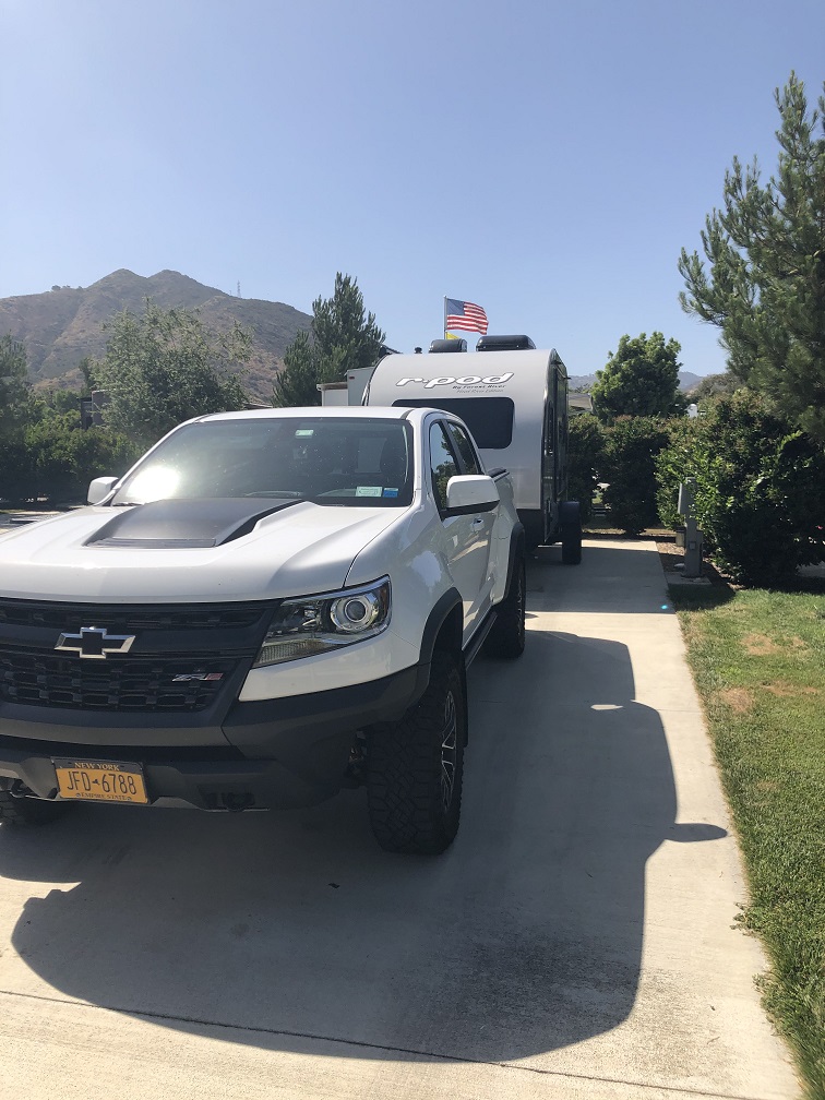

2018 Chevy ZR2 with 2020 P-Pod 190

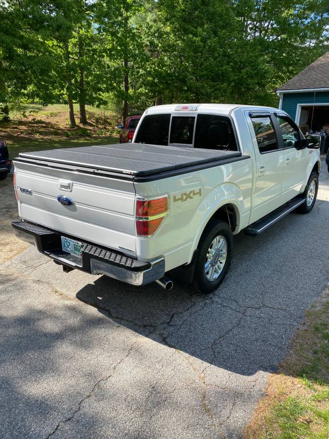

Question about best tv ball setup. I am picking up a 2012 Ford F-150 with a 2" receiver.
Wondering what the best setup is for towing an RPOD 190?
Thanks!
AC
Post Options Post Options   Quote offgrid Quote  Post ReplyReply Direct Link To This Post Posted: 07 Jul 2020 at 4:09pm
Nice looking truck. Are you thinking you want a weight distribution hitch? It will most likely tow nicer for you, but probably optional for that truck. I'll let the F150 folks chime in...
Posts: 3326
Post Options Post Options   Quote jato Quote  Post ReplyReply Direct Link To This Post Posted: 07 Jul 2020 at 5:49pm
We pulled our 177 for nearly 6 weeks last year with a 2011 F-150 using only a Curt anti-sway bar in the Rockies and to and fro from northern Michigan.  We put on over 7000 miles in the process.  No problems. So far this year we have put on just over 1000 miles using a newer 2017 F-150 3.5L with Ecoboost, again using the same Curt anti-sway bar.  And again, no problems.
Andyrpod190 View Drop Down
Joined: 03 May 2020
Location: NH
Posts: 40
Post Options Post Options   Quote Andyrpod190 Quote  Post ReplyReply Direct Link To This Post Posted: 07 Jul 2020 at 7:02pm
So I bought a Blue Ox WDH. Suppose to be the best. I have been told that without it in N.E. should be fine as the pickup I bought has built in anti-sway. Will try it without it and will put it on when going from NH to WY next year!
So this is a class IV receiver. Rated up to 12,000 lbs, but the pickup I have is at 7700 lbs towing capacity.
So really just trying to find the correct ball for the hitch. I know there are many types that go into the receiver and have adjustments, etc... depending on the application.
AC
