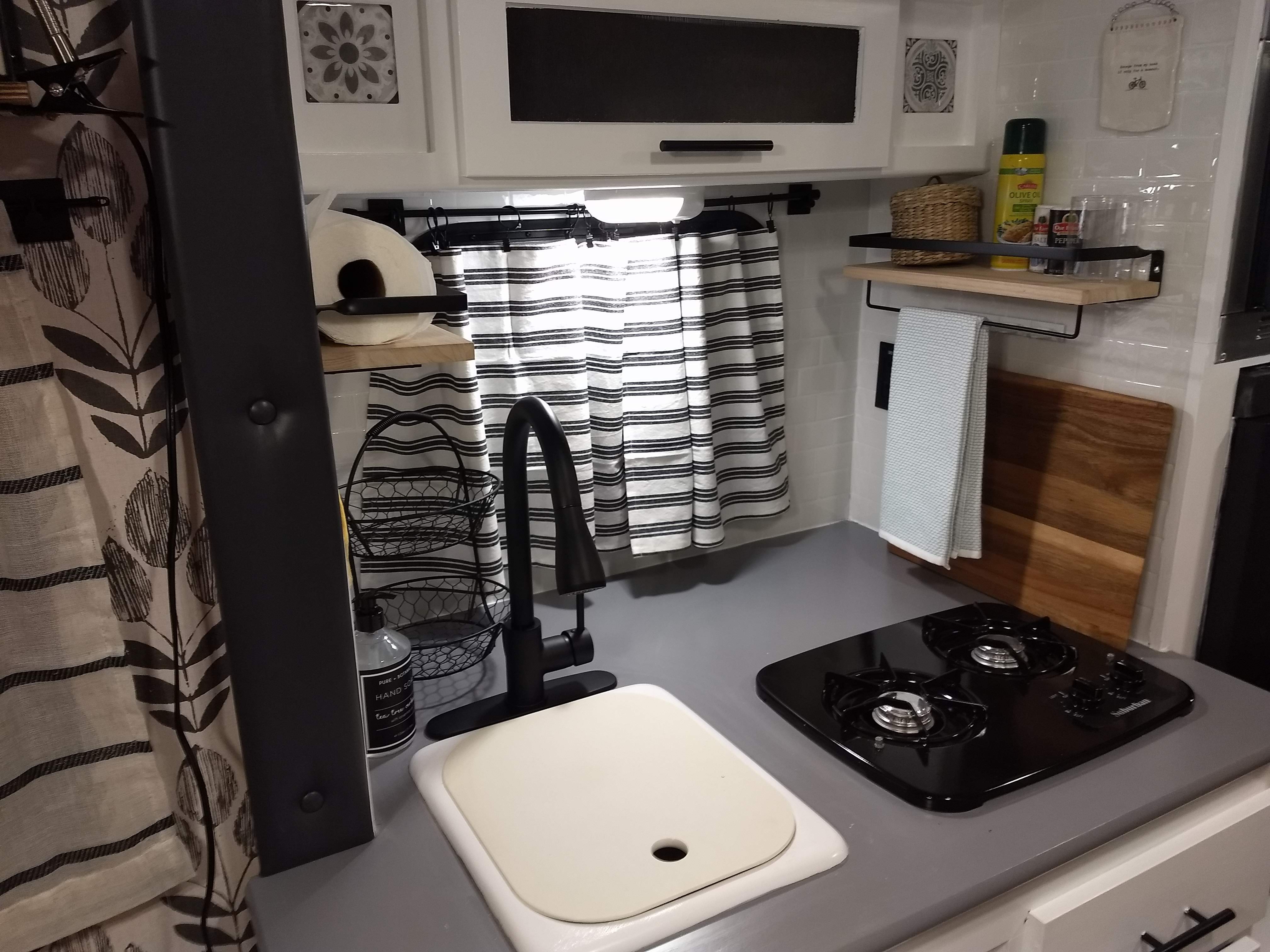

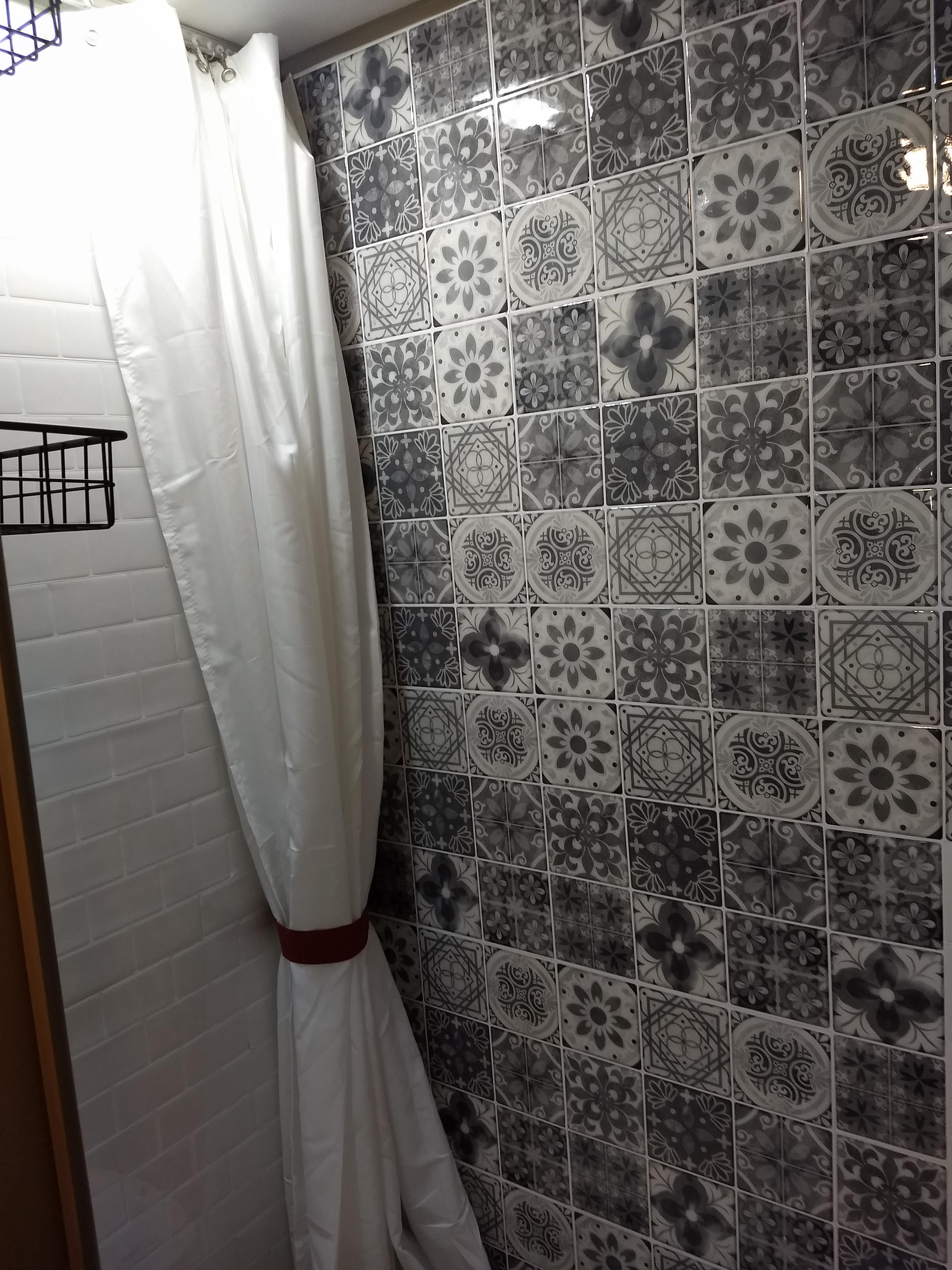

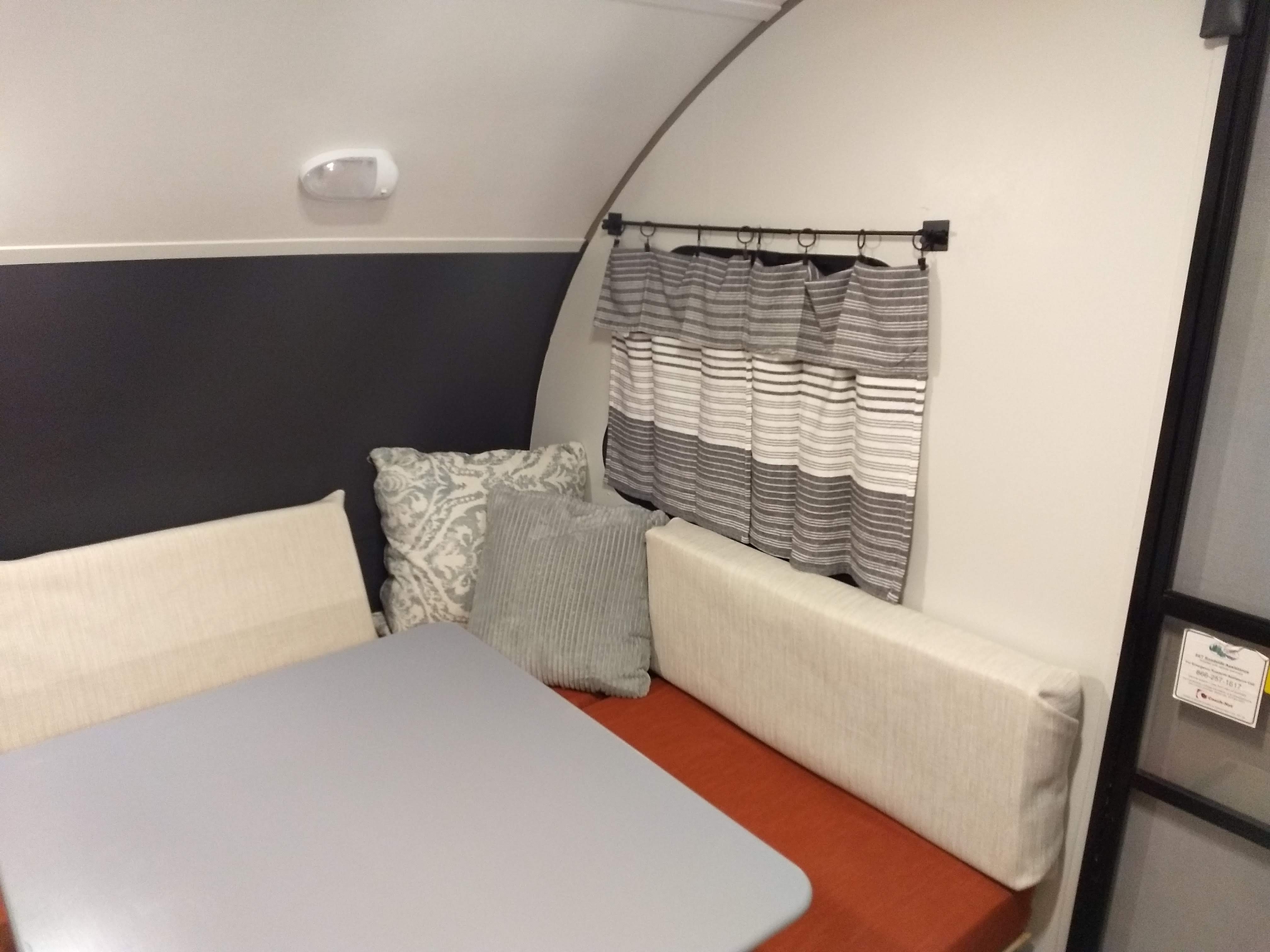

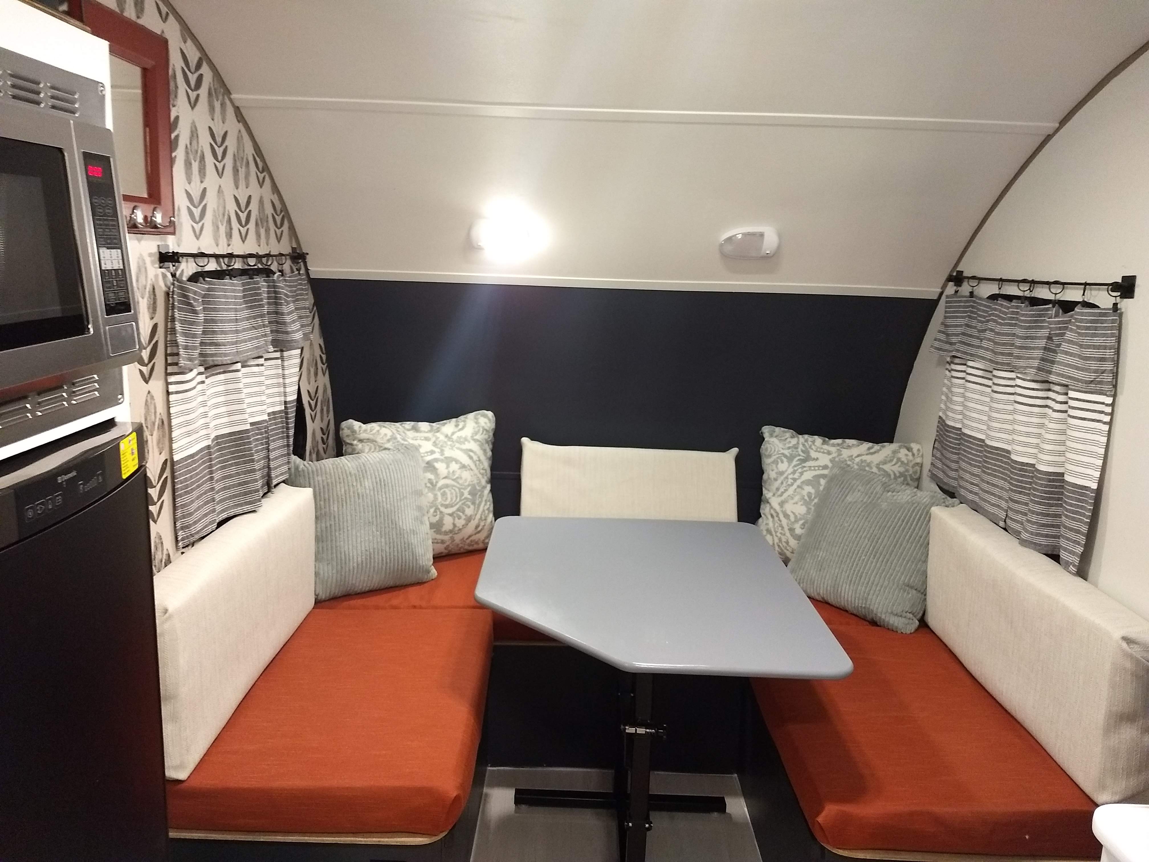

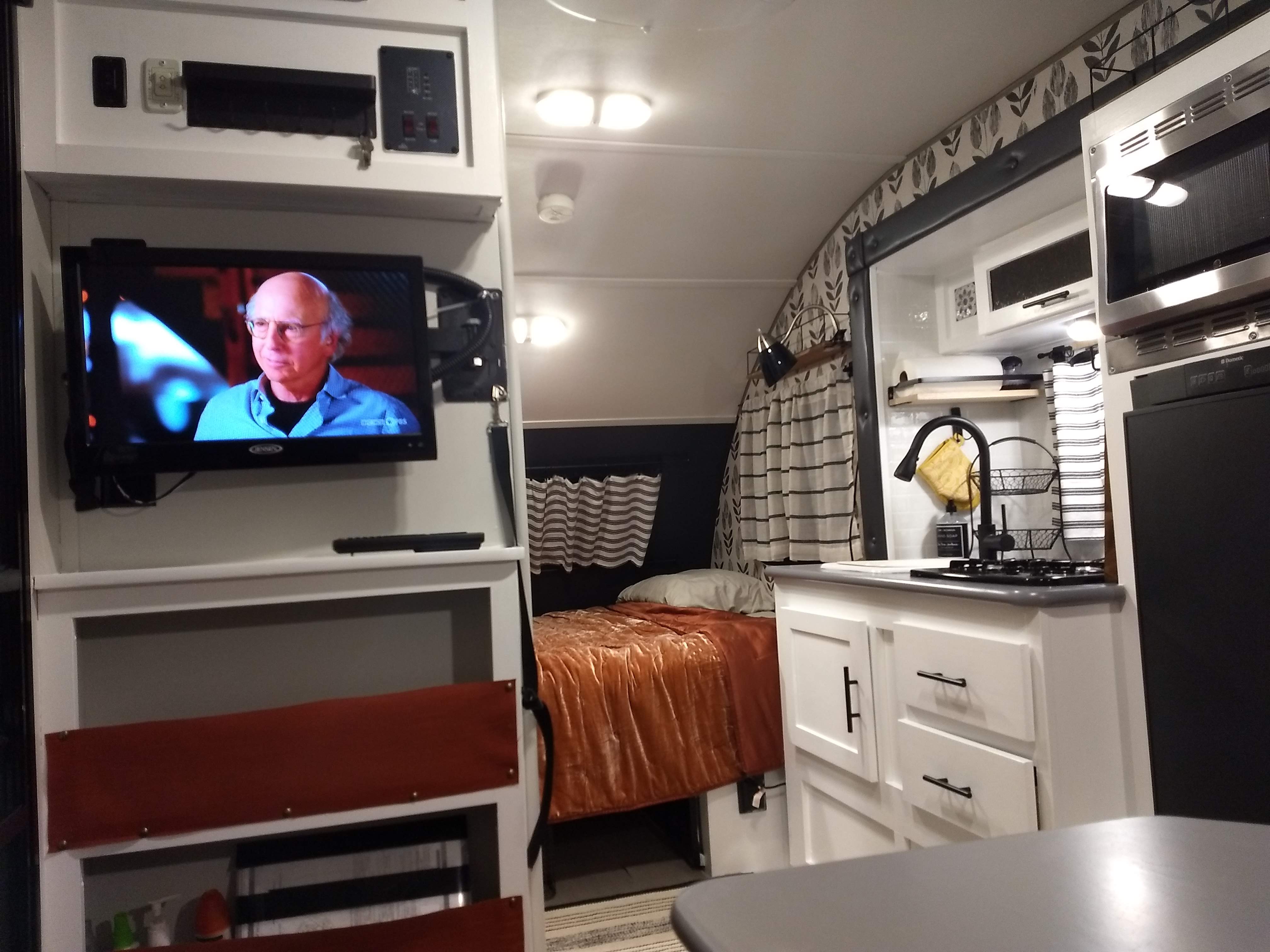

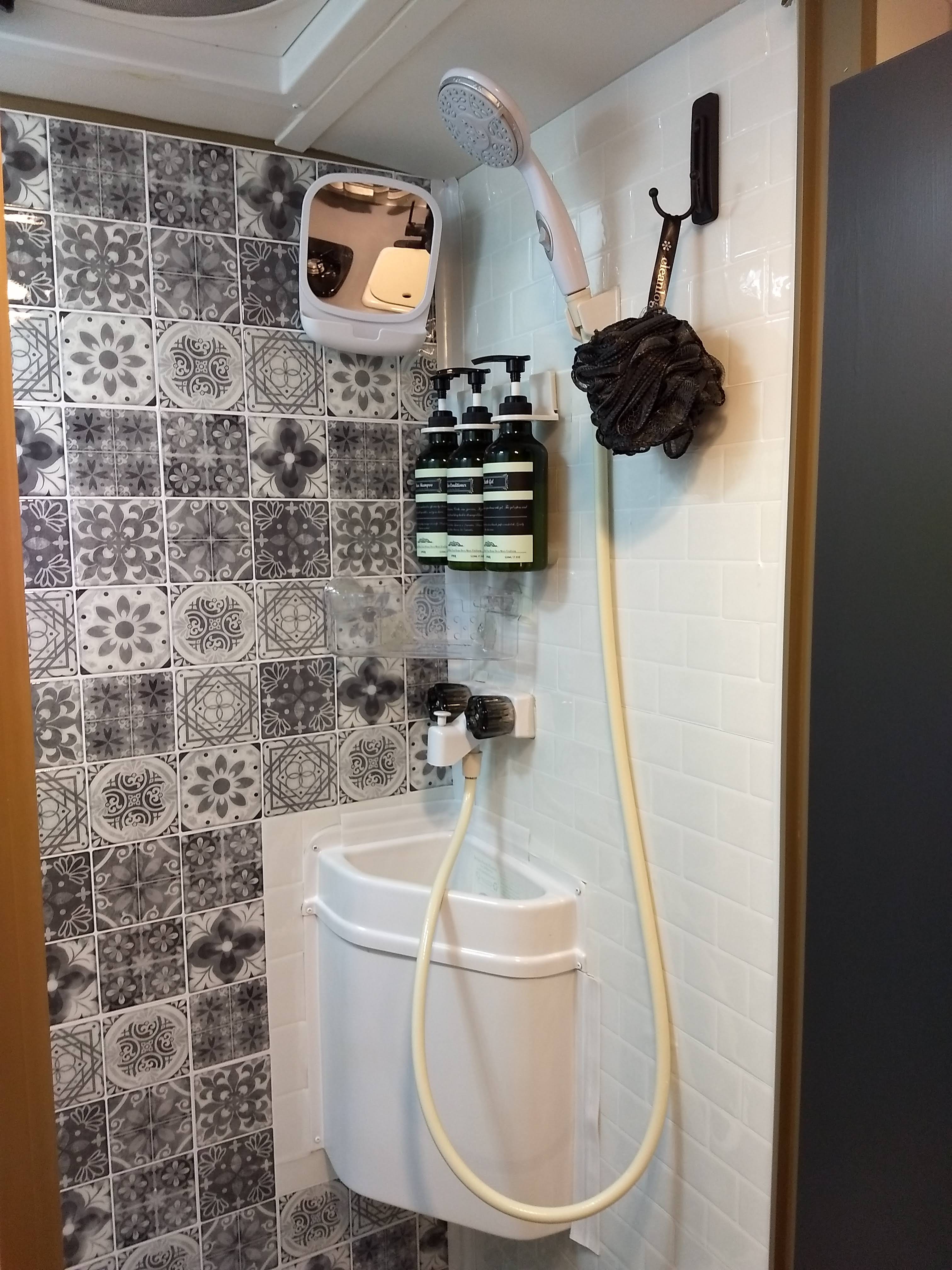

![]() I bought an 2015 178 this fall and have spent the last few months completely remodeling it. It is pretty much finished, and we are heading out this weekend for a last minute trip to Tennessee. I changed the sink faucet, used peel and stick tiles in the bathroom and kitchen area, used rustoleum countertop paint for the kitchen counter and table, used hand towels for the curtains, added shelving, put hinges and cabinet openers on the benches, have new peel and stick flooring, and have large baskets underneath the benches for food storage. ![]() ![]() ![]() ![]() ![]() ![]() Here are the links to the items I used, I also used peel and stick grout to help cover the rough edges and keep the water from going behind the tiles. *update, this fell right off.
https://smile.amazon.com/gp/product/B07HRLYZD3/ref=ppx_yo_dt_b_asin_title_o00_s00?ie=UTF8&psc=1 White tiles *these did not stick well in bathroom, they did better in the small kitchen area. After the winter, a lot were separated from the wall. I have been pushing them back on, and I am wondering how they will do in the heat. https://www.wayfair.com/home-improvement/pdp/art3d-11-x-11-pvc-peel-stick-mosaic-tile-dtar1285.html mosaic tile *this tile stayed on pretty well. I am happier with it that the subway tile. https://smile.amazon.com/gp/product/B000BQS4AG/ref=ppx_yo_dt_b_asin_title_o05_s00?ie=UTF8&psc=1 peel and stick grout *update fell off. https://smile.amazon.com/gp/product/B07X65DXQT/ref=ppx_yo_dt_b_asin_title_o06_s00?ie=UTF8&psc=1 hooks to hold up curtain rods *did not work well on the wallpaper sections. They pulled down the wall paper. I switched to small, screw in hooks to hold up the curtain rods. https://smile.amazon.com/gp/product/B07CPBKQXY/ref=ppx_yo_dt_b_asin_title_o00_s01?ie=UTF8&psc=1 little shelf and hooks for keys for above TV area https://smile.amazon.com/gp/product/B07PWV8T39/ref=ppx_yo_dt_b_asin_title_o04_s01?ie=UTF8&psc=1 new shower curtain https://smile.amazon.com/gp/product/B086ZDB3DW/ref=ppx_yo_dt_b_asin_title_o05_s01?ie=UTF8&psc=1 floating shelves https://smile.amazon.com/gp/product/B07PKNZN1H/ref=ppx_yo_dt_b_asin_title_o06_s00?ie=UTF8&psc=1 soap dispensers *these too fell off. ![]() ' https://smile.amazon.com/gp/product/B0759KM3P2/ref=ppx_yo_dt_b_asin_title_o08_s00?ie=UTF8&psc=1 shelf for over microwave and bed https://smile.amazon.com/gp/product/B08BSQ84QF/ref=ppx_yo_dt_b_asin_title_o03_s00?ie=UTF8&psc=1 flooring *It seems like the flooring has expanded a little, so some of the tiles are lifting a little. https://smile.amazon.com/gp/product/B075MMMMFT/ref=ppx_yo_dt_b_asin_title_o04_s00?ie=UTF8&psc=1 wallpaper https://smile.amazon.com/gp/product/B01AHHCHBK/ref=ppx_yo_dt_b_asin_title_o05_s01?ie=UTF8&psc=1 lid supports for under bench storage https://smile.amazon.com/gp/product/B07XYQ59CF/ref=ppx_yo_dt_b_asin_title_o01_s02?ie=UTF8&psc=1 faucet I got the paint at home depot, also took some trips to our local Home Goods store for the towels and other things for the kitchen area. I also took out the back of the cabinet under the sink to have a lot more room for storing pans, etc. |

Wow! That's beautiful.

Yes, it definitely brightens up the interior. I like your "tiled" bathroom. What did you use for that?
MelissaJoy ![]() Newbie ![]() ![]() Joined: 12 Oct 2020 Location: Michigan Online Status: Offline Posts: 16 |

Great mods MJ. Very impressive! For the floating shelves in kitchen area, how do you secure the screws into the wall to hold the weight of shelf and contents?
