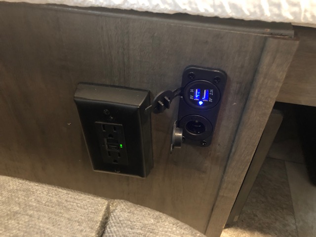

- My Apple iPhone 8 makes a great video player as it has 256 GB of memory and I can download shows/movies from Netflix and Amazon Prime to watch on the Rpod TV with HDMI input. To do this you need the Apple lightning to HDMI adapter (only one that works with protected content). You also need a 12V DC to AC converter to power the TV when only on battery and install a 12V cigarette lighter socket to power the converter, which I installed up by the TV spliced into the entertainment system 12V power to power it. I also put a combo USB port/12V socket by the bed so I can charge my iPhone and 12V vacuum I also carry. It is mounted on the bed platform next the AC outlet and spliced it into the 12V used for the furnace.
