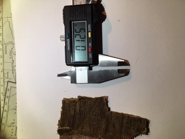

Giving a special shout out of thanks to Belinda for her help with an identical problem on a 2015 179 R Pod.  Attached are photos of the broken floor joist approximately mid span of the slide out. This resulted in a downward shift of the sidewall of 1-1/2 inches.  I find it hard to believe that Forest River does not have more of these issues with the light weight RVs they manufacture using the same design. Having a composite floor supporting an overhanging outer wall without outrigger support is simply unacceptable.
 Not only is the design flawed, but the pitiful excuse for welds is beyond belief.  The square tubing itself that make up the floor joists is only 1/16 inch in wall thickness and the Luan plywood is 1/8 inch.  I will be using the same remedy as the original post and have outriggers manufactured and welded to the frame.  The existing floor will be a mess to clean up with mold present over 40 percent of the floor space.  I will go back with a 3/4 inch marine grade plywood.  The only alternative I can see is to scrap it and sell it for parts.
