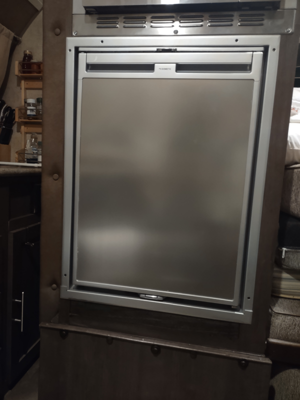

Front view of completed installation:
CRX1110 Installed

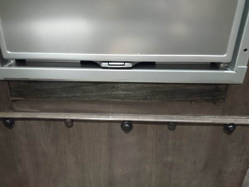

Detail view of support platform below refrigerator:
The stain was ebony with a little gray mixed in. It isn't quite a match, but it is good enough. I finished it with polyurethane spray.

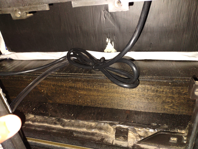

This is a view of the base from the back side. Note the insulation bats around the base and sides. What is not visible is the layers of insulation I put in behind the panels. That was the pink foam from Home Depot cut to fit the spaces. This was finished with ebony stain and polyurethane spray.

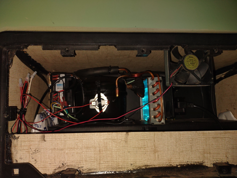

This is a picture of what makes this work. The compressor is tiny as is the condenser and fan when compared with one that would be in a house. It is also variable speed which contributes toward it being energy efficient. I added a thermostat and wired in the fan removed from the old refrigerator. I intended to use the old thermostat, but the start temperature of that was too high. I ordered a new one that starts at 100F and cuts off at 85F. It is wired to the 12V line that supplies the refrigerator, so it is not modifying the refrigerator in any way. I strapped it to the compressor with heavy wire ties that were rated for a higher temperature than I could anticipate the compressor reaching. Note that the top of the compartment had to be raised to allow the unit to slide into place. I did not realize it when I built the platform that this would be needed. I could have saved some work if I had not built the platform but just made a filler for the top end instead. However, having the refrigerator sitting a little bit higher is nice for accessing the interior.
I installed the fan to help exhaust heat from the compartment. It is likely not needed, but it can't hurt. The additional insulation should also help to reduce energy use.  I will likely add insulation to the back of the refrigerator as well below the compressor.

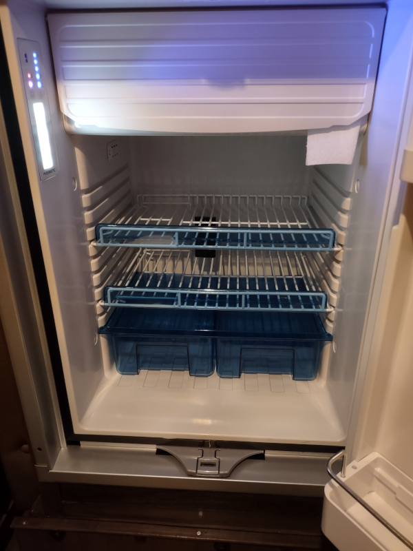

And, a shot of the inside.
Unlike the old refrigerator, the controls are built into a panel on the inside with no wires or controls to have moisture intrude. The lighting is LED. The freezer is different in that it opens from the bottom up intead of the top down and the compartment is not removable. The freezer does work very well and should be suitable for ice cream and any other items that need to stay frozen. The shelves go all the way to the back and have a lip on both the front and back to help keep things in place. The crisper bins are rectangular and not rounded like the old refrigerator. They are not on a track so they can be removed and replaced easily. The shelves are deeper as well and will allow for larger items to fit. The door shelves are not as wide though. The bottom shelf is deep enough but the top two shelves are narrow. They can be removed, but they can't be adjusted since there are not other mounting points. Still, the deeper shelves are a huge plus over the old one and there are no intruding fins in ether the refrigerator or freezer compartments.
