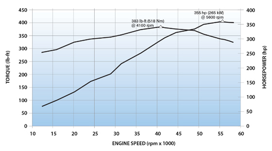

I will argue that a turbo V6 is simpler than a NA V8. Only 75% of the moving parts. And the extra 25% of parts in the V8 are the most failure-prone reciprocating parts. It is very old-school to argue that turbos add significantly to maintenance. 90+ percent of all diesel big rigs are turbocharged, and have been for decades. The turbochargers in EcoBoost engines are very, very reliable. If you think that turbos contribute significantly to reliability issues, your turbo-knowledge is still in the 20th century.
... and I still say for practical purposes that the 2.7L EcoBoost has more useable torque than a typical 5-liter-ish V8. Gander at the torque curve of the 3.5L EcoBoost versus a "higher horsepower" V8. At 1500 RPM the EcoBoost is generating 200 more ft-lb of torque than the V8. The V8 doesn't catch up until it's turning at 4700 RPM or so. That lower RPM torque curve is way more useable than the one in the V8. In other words, the V8 is screaming, and the EcoBoost is just toodling along. The 2.7L EcoBoost has a similar torque curve as the 3.5L, just a little lower. It still beats the V8 at 1500 RPM by almost 150 ft-lbs.
