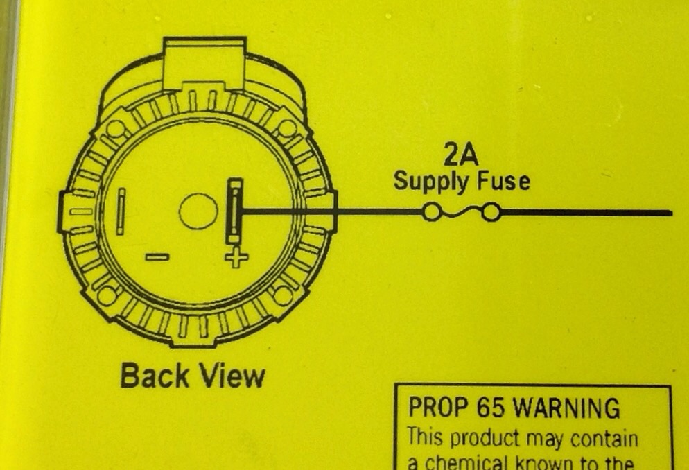

My blue sea USB charger port indicates a 2A supply fuse.  Do I need this in addition to the 15 A fuse in the breaker box.
Direct Link To This Post Posted: 10 Jul 2016 at 7:30am
If I understand your situation correctly......
Installing a 2 amp fuse would limit the amount of current to the charging port to 2 amps. If the device exceeded that, the fuse would blow. Most phones, tablets, etc. require less than this.
This might "come into play" if the device being charged were to malfunction and pull more than 2 amps. The 2 amp fuse would blow before the 15 amp fuse. Your 10 or 12 gauge wire should handle the 15 amp current OK so, little danger of it overheating/fire. If the device is pulling 15 or more amps, the 15 amp fuse will blow. In either case, if you are blowing fuses when attempting to charge, your device probably needs serviced or replaced.
So, in short, installing the 2 amp fuse would be good and most safe but, you would probably be OK without it.

Thought it was kind of strange. It's not like it is going to protect the phone from a surge of any kind, right. . It also says it is a 2.1A plug. I would think if anything else shorts the plug the 15 A fuse would blow.

Originally posted by dherman201
Charlie do you prefer the cigarette lighter socket and then use the USB adapter .  I bought a couple of USB sockets and thought I would just use them.  Guess the cigarette lighter socket gives some other options.
The USB 12V sockets with USB adapters are just a bit more versitile, and less expensive to replace if they fail, but the Blue Sea products are excellent and will serve very well. To your later post, the extra 2A fuse is not required. The fuse is to protect the wire, not the device. #12 wire protected by a 15A fuse is adequate. The USB adapters themselves would not require #12, smaller wire could be used since the total for two would only be 4A, but I would run #12 anyway. It's just as easy and you might want to change or add a socket someday.
Just to be clear, the fuse is not there to protect the device. It's there to protect the wire. You can connect wire that is just large enough to easily carry 2 amps to a terminal that is fused for 15 amps as long as you include a 2 amp fuse.
If your 2 amp device fails and draws 14 amps, it will blow the 2 amp fuse but not the 15 amp fuse. If you do not include the 2 amp fuse, the wire will overheat to the point of catching on fire. Fire is bad.
