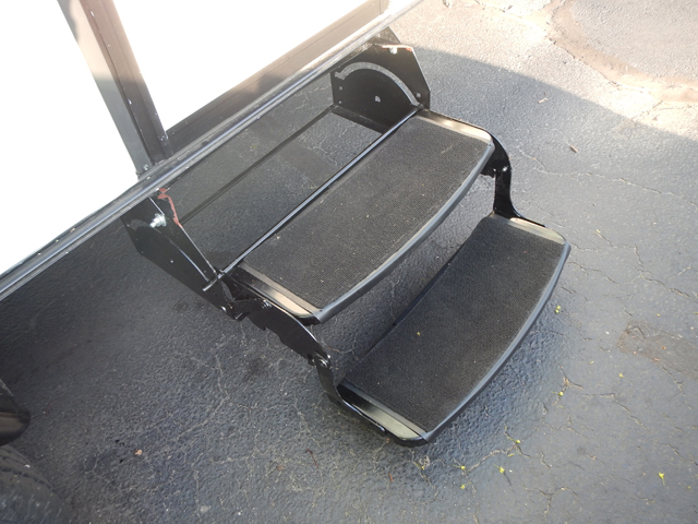

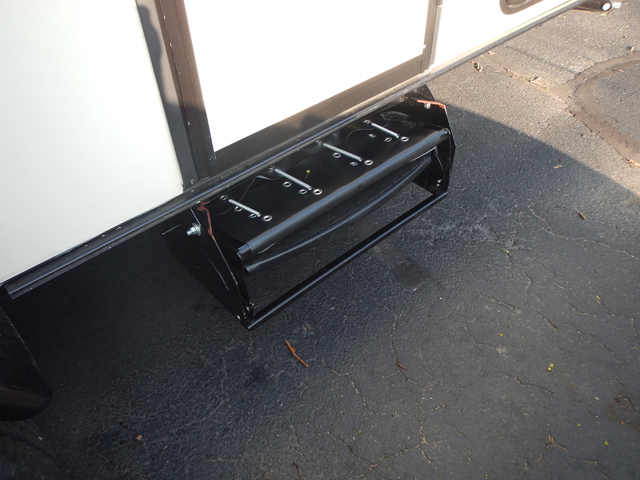

Does anyone have a picture of the Stromberg Carlson 2 steps installed in the up, or travel mode position? We recently purchased a 2016 RP178, and after two trips, I want to replace the one step with a two step. My only concern is ground clearance in the 'up' position, although I doubt if that will be a problem. So far, our experience with our Rpod has been fantastic! Thanks for all the helpful advice on this forum.

I just put them on our 179. Does reduce ground clearance behind the wheel by about 2".  Not throwing the old steps away just yet, but I don't think it will be a problem.  The rear jacks are more of a worry.

Purchased a 2016 RP178 also.  I can't speak specifically about the Stromberg Carlson steps but we did replace the original single step with the Flexco double step from etrailer.com.
The Flexco steps, after installation, extend 11 inches from the r-pod with 8 inches of clearance to the road.  One of our favorite mods we made.  Just a note:  The bolt holes don't line up exactly so I had to modify it to fit properly.
