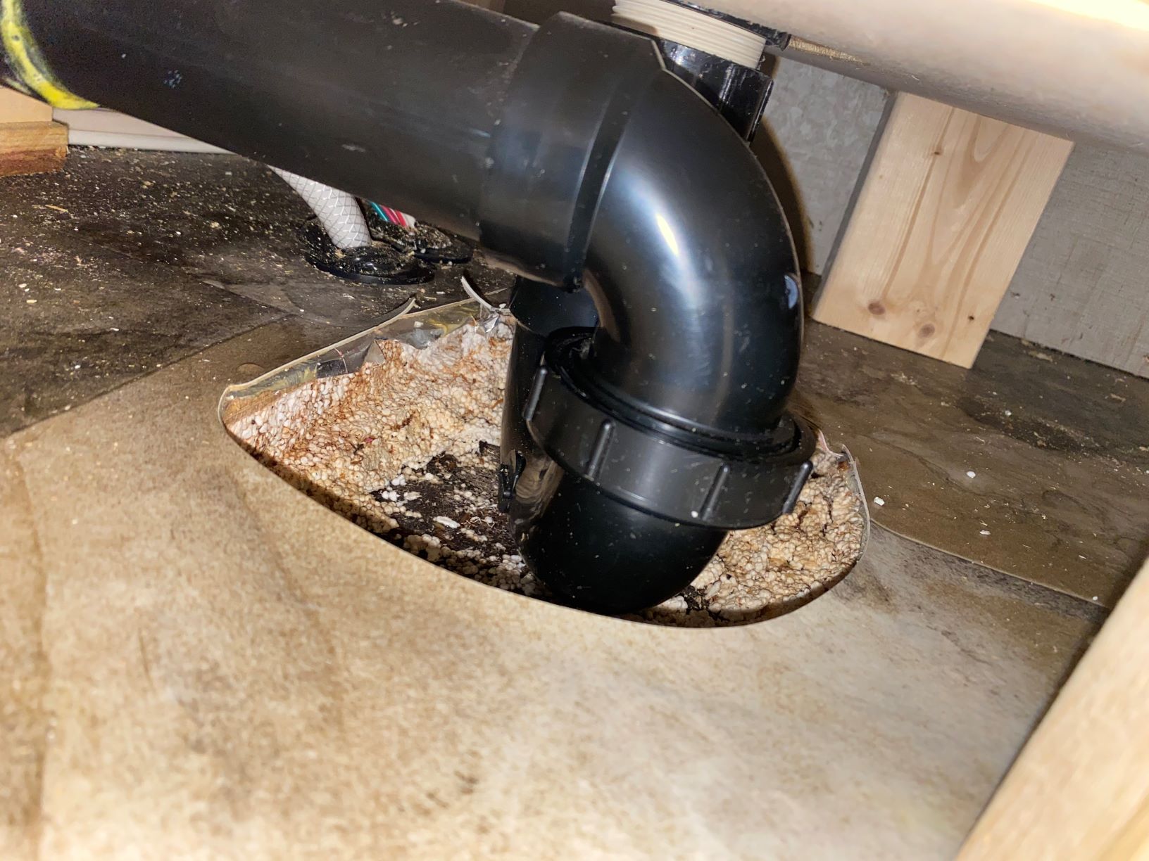

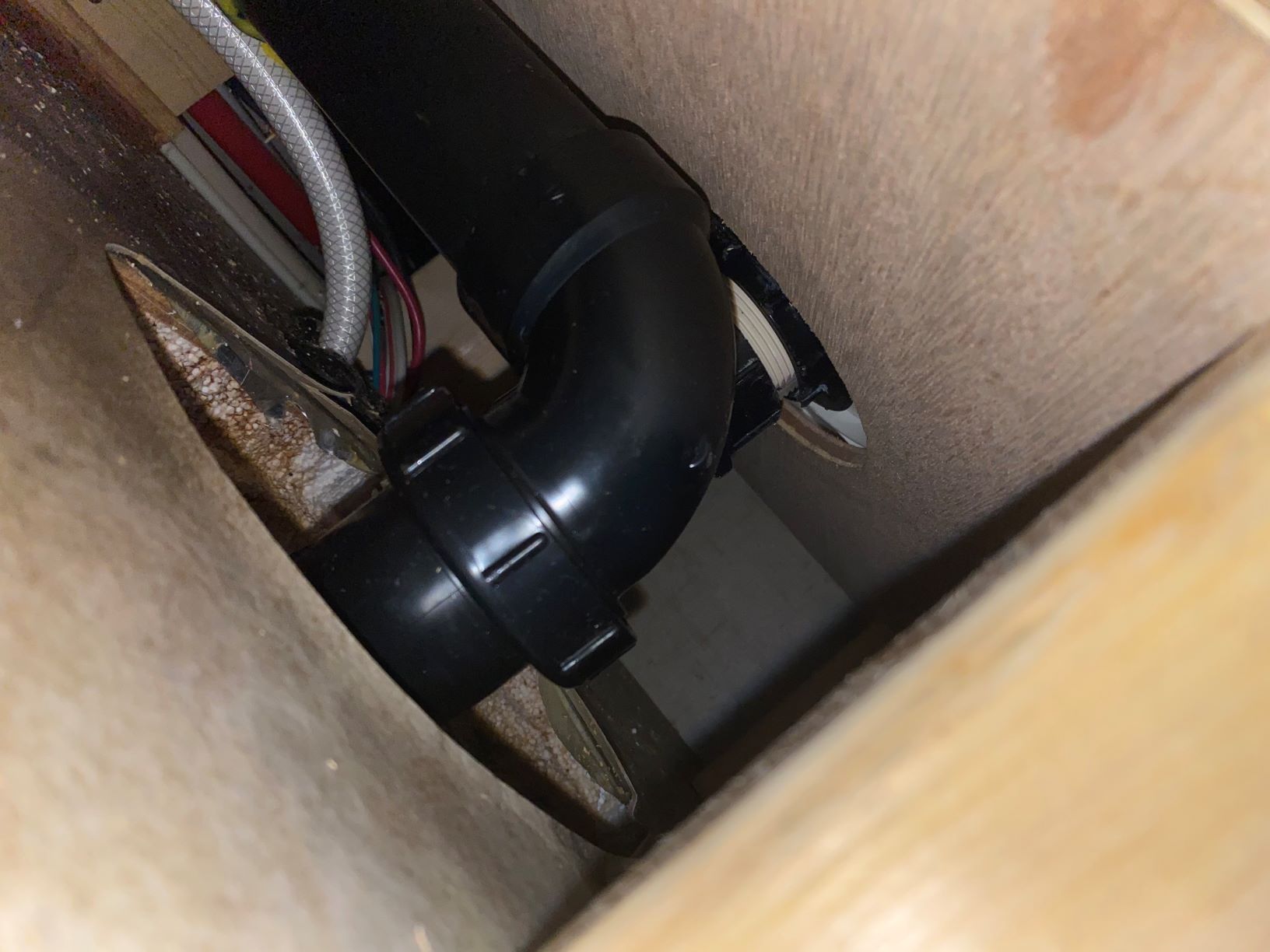

i have R180, with corner shower, separate from toilet. there's a leak in the bottom, because the drain flange isn't in tight enough.  I have a reinforced  platform underneath, but with just 3"-4" access hole, I can't get a hand around the reinforcing platform to try to tighten the flange nut underneath. Even if I remove/replace the shower pan, how do I get it back together tight enough, if I can't even reach in and snug it up now?  In mine, part of the floor has a cavity shaved into/carved out of it to make room for the p-trap. there's only about 5" from bottom of pan to top of floor. I'm thinking about cutting a new, larger, access panel in the side of the shower floor pan, but I want to know how I'm going to cover it over before cutting it open.

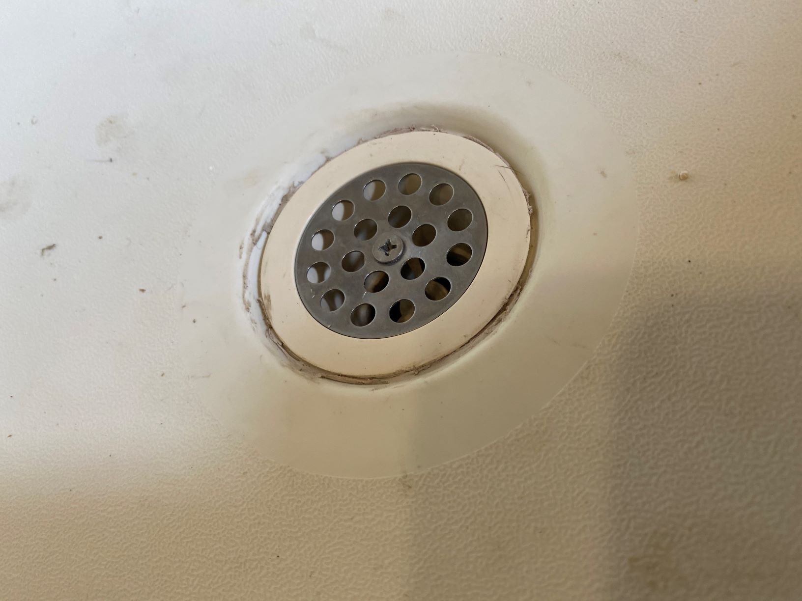

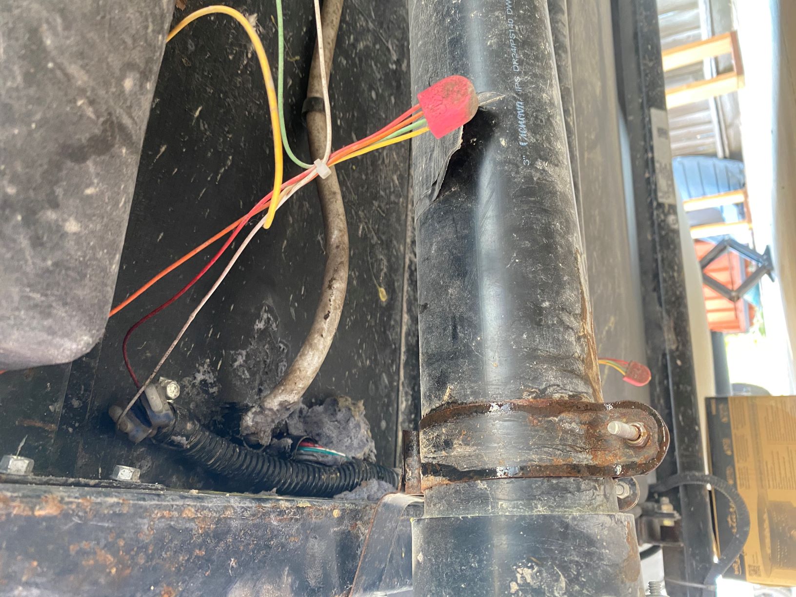

update!  I was able to get in there, after a little more persistence, with a large channel lock to tighten down the flange collar.  plumbers putty squeezed out from the top, and the flange leveled out and firmed up. it won't slide around anymore.  However, in order to see where the leak was coming from, i cleared away all the black foam.  how necessary is it to replace the foam?  would great stuff work?
posting pics in case this helps someone else someday.
leak underneath:
flange under shower drain (now tightened):
p-trap with part of floor removed, this was holding leaked water until it leaked out:
shower drain with plumber putty squeezed out:
