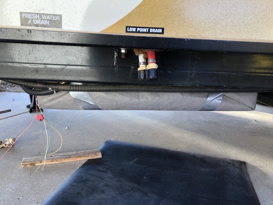

Thanks for the update texman. What you've done so far doesn't look that bad to me not having seen the process of getting it to that point. That landscape cloth is strong stuff, it really should hold up to highway speeds. Of bigger concern is if the insulation board falls down and there is a gap where air gets in.
If you do decide to start over with foam I wouldn't worry about the mess, especially if you have the tank out. I foamed the perimeter of my house from underneath and wore old clothes that I keep around for that purpose. Definitely wear goggles, a hair cover, and gloves, and do it outside on a warm day on a sheet of plastic that you will trash afterwards. And don't ever try to clean the stuff off anything until it fully cures Thumbs Down.

That looks like a heck of a lot of work Texman.  You make me feel lazy.
Is there something you are going to replace the duct tape with?  That stuff looks like the weak link in the package.  Also, what if you bought a flat piece of sheet galvanized sheet metal that you could cover the whole thing up with and screw it fore and aft to the metal that holds the tank or use the TPO you already have?  That way, you'd reduce the windage on the cloth.  The it's made to be wet in the dirt, so it could be there for a very long time if it doesn't get ripped off by the wind.

Tape was just to hold the fabric while installing. No function now. The fabric is held now by compression against the pod floor and also by the weight of the tank on the tank mounting arms.

After a quick read it sounds like the flame treatment is really the only plausible way.  The working times are way to short on the treatments to get everything done in that window of time.  The problem i see with my current situation as well as spraying the tank with foam when removed is that the upper third of the tank is un-insulated.  Reason is, if the tank is completely covered  with either substance while removed, it will not fit back into the framing that supports it. Therefore, my thinking is that the best would be to spray the tank while it is mounted to the pod and cover the upper 1/3rd and the metal framing.  That would be the best way i think.  It will be a problem at ends of the tank since there is only about 2" on either end between end of tank and the trailer frame.  that would have to be filled with foam as best you can i think.
meanwhile, back to my situation.  as i just said, the best approach to this is spraying the tank while installed.  the tank is apox 15 sf by my calcs of surface area excluding the top.  so if i have 1/3 of the sides unprotected that is 2.23 sf ft or 15%.  That is where i am at now.  So is that good enough to test with for awhile?  i think so at this point, especially since it is the top 1/3 right next to the floor that is heated on the opposite side. The real question for me now is will my currently applied materials withstand highway speeds, rainy highways, etc. and not fly off on the interstate and cause who knows what when a 10 sq ft piece of insulation and landscape fabric appear out of nowhere to a driver behind me?  i am not confident enough to try it in its current state.
So i have to cover what i have with the TPO (or something else) which is doable i think or start over and go to foam.  But at least i wouldn't really have to worry about the foam coming loose if the tank was flame treated and had a proper bond and i could insulate that upper third.  I dont think the upper 1/3 or 15% is going to make a noticeable and measurable difference really, just trying to talk through all this and make sense of it and give you folks something to read.  Especially if i wrap it again like i said.
Still contemplating but i am leaning towards trying to at cover what i have and go camping. Smile
