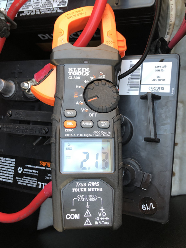

made some progress i think.  I pot the new batteries in the pod and let them charge all night.  i checked current this morning and read the following:
first try at 7:18 was 5.13 -5.28 amps on battery= 62 watts
2nd try at 7:57 was while still charging was 2.61 amps
on battery only was 2.13 amps or 25.6 watts. not sure what changed between 7:18 and 7:57, on battery only during this time. maybe it takes a while to level off. no lights, nada.  should only be stereo(cant find a fuse for that)  propane monitor and other always on stuff.  i have a usb charger with an indicator light and the meter i just added as well.  Is that a normal current for all off that can be off?

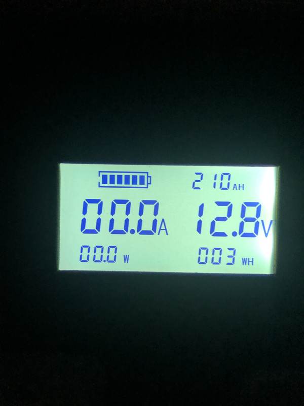

I got the new hall meter set finally.  Instructions need some english education.  the next challenge on setting it up is to clear the current to a base reading with no load.  in order to do that, it must be powered, obviously.  Only thing i  can think of is maybe use a 9volt battery and clear it all or run a jumper direct to the pod batteries and clear it so it reads the loads correctly.  Right now it is cleared to no load at all when on battery because i cleared it to set it up.

does the sequence need to be followed as indicated?  battery then red then yellow then hall sensor then controller?  i think the red is just for monitor power and not measurement.  if the sequence is to be followed then i will need to jump wires to the battery box.

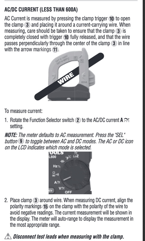

When you use the current meter, it's recommended that you get the wire as close to the center of the loop, and oriented as close to perpendicular to the loop. Your picture shows it coming through at an angle. I don't know how much this affects the reading, but the Klein manual makes a point of it.

Glue - i was looking at the picture i guess.  but this isnt that clear to me either.  item 2 talks about the polarity markings which is what you are referring to correct?

+1 to GlueGuy on getting the clamp on centered and perpendicular, and also well away from any other current carrying conductors or magnets. Also, hall effect DC current sensors are also notorious for getting out of calibration and needing to be zeroed out. Be sure it reads zero amps when not clamped on or near a wire.
2A with everything off is too much.  If it was and the current meter is set to zero before being clamped on then there is a parasitic load somewhere I think. I only get maybe 100 milliamps IIRC. Did you try pulling the 40A fuses?
Haven't looked at your meter manual but I don't think it shouldn't matter what the sequence is for the red and yellow wires. The yellow is probably a voltage sense wire that they are keeping it separate from meter power to get an accurate voltage measurement.

The two "-" markings on either side of the loop are about where you want the wire to pass through. And the wire should be close to perpendicular to the plane of the loop. The picture they provide is misleading, as it "looks" like the wire is going through at a 45 degree angle instead of a 90 degree angle.
I'm also agreeing with offgrid that a 2 amp parasitic is too high. Normally, I would expect the parasitic load to be in the neighborhood of a 1/2 amp or less. I think I measured ours at around 1/3 amp (don't quote me on that, it's been a while, but I do remember it being milliamps, and not amps).
