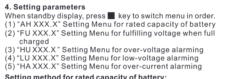

what do you guys think i should use for the settings?  AH is 208 These are the setting on the battery monitor that i added.
