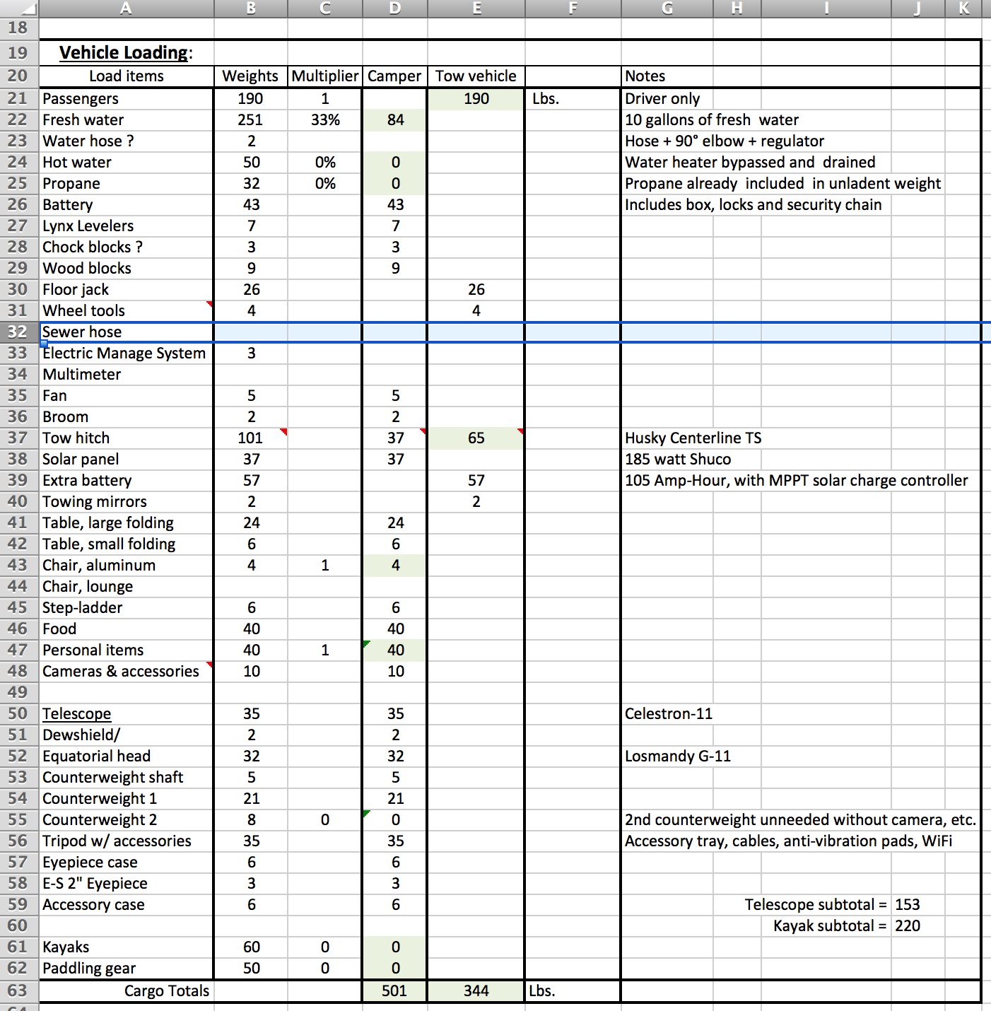

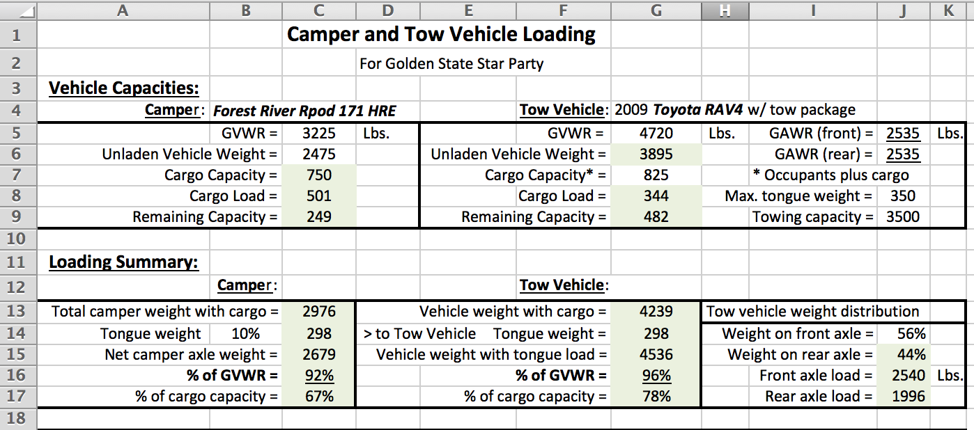

I've continued to use my spreadsheet for determining loads for trailer and tow vehicle. At the end of June I'll be taking my first long trip with the camper. One question that has come up in my mind is how to determine the tongue weight. I know they recommend that around 10% of the camper weight should be supported by the tongue. But how can you measure that? One can assume there is weight on the tongue since the camper isn't doing a wheelie when the stabilizer jacks are retracted. But how can one prevent overloading the tongue?
One solution I've come up with (but as yet not tested) involves using a regular 250 pound bathroom scale. I can support the tongue jack on a 3 foot long 2x6 board, one end of which is supported by a block of wood on the ground, the other end supported by the scale. If the tongue jack is at the 1/2 way location on the 2x6, then the scale will read 1/2 the tongue weight. So when I get 300 pounds tongue weight, the scale will read 150 pounds.
Has anyone come up with a better way to measure tongue weight short of getting a 350 pound capacity scale? Does my plan seem like it would work?
In any case here is the latest iteration of my loading summary:
Here's the loading plan:
Comments and suggestions would be welcome.

Thank you so much for all the work you put into this. I am just getting started acquiring an R-Pod and tow vehicle and this spreadsheet puts my mind at ease regarding how much gear I can bring with me and not exceed limits. Thank you again. I see you added a few items to your screen shot. I will add some of them to the spreadsheet. I have deleted the telescope.

Jim I'm pleased you found the spreadsheet to be of use. As you have shown one can easily modify the cargo list and weights to match your own circumstances. Determining the tongue weight was easier than expected. My bathroom scale reads up to 350 lbs. So as I loaded cargo in the Rpod, the scale kept track of tongue loading, ending with 325 lbs. This is within the tow vehicle's maximum of 350 lbs. with loading being 11% of trailer weight. To get this I had to load quite a bit of cargo on the rear queen bed. Evidently the Rpod 171 is a bit heavy on the tongue. Also quite a bit of the telescope's weight was forward from the axle. Only the telescope's optical tube was on the rear bed.
On the way to my first campout the trailer was weighed at a public roadside truck scale with total weight of 3000 lbs. Also the tow vehicle weighed around 4500 lbs. with 52%/48% front-rear loading. This kept the Gross Axle Weight loading well within limits. This is all in line with what the spreadsheet had predicted. So it is a good tool to keep loads within safe limits.
