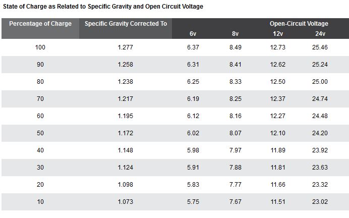

Wow, that is a lot of information to process.  For the most part we boondock, hence our 2 marine batteries come into play a lot.  I have been told, and maybe you already know the answer, that the deep cycle battery should only be drawn down to 1/3 of its full charge before recharging.  This is what we have done since we purchased ours in 2011.  In the winter months I take them out and give them each a trickle charge for a day and put them in our basement until the following spring.  Any advice? Last I checked they still are holding a great charge after nearly 5 years.
Direct Link To This Post Posted: 18 Jan 2016 at 11:38am
We left ours in all winter, with the pod plugged in. By "marine batteries" do you mean 12v rv/marine? if so, then you should never let them get below 50% SOC. If you have a setup like our old, 2 12v Group 24 RV/Marine batteries. Our 12v batteries tested 100% life when we turned them in as cores for our Trojan T-105s. 5 years old.
Those dual 12v are good for about 55-65aH of useable storage. We switched to dual 6v GC-2 sized batteries, fit in the same space, gives us about 110aH of useable storage if we pull to 50% SOC.. almost double, without taking into account that we do now have true deep cycle batteries and can pull them as deep as we need, though I hope we never really have to take them below 50%, but know it won't be "as hard" on them if we do.
