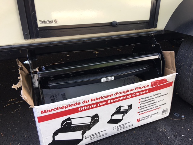

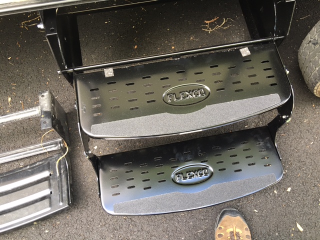

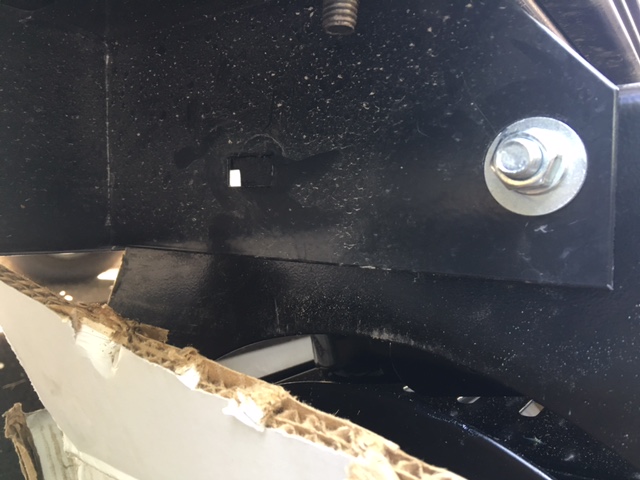

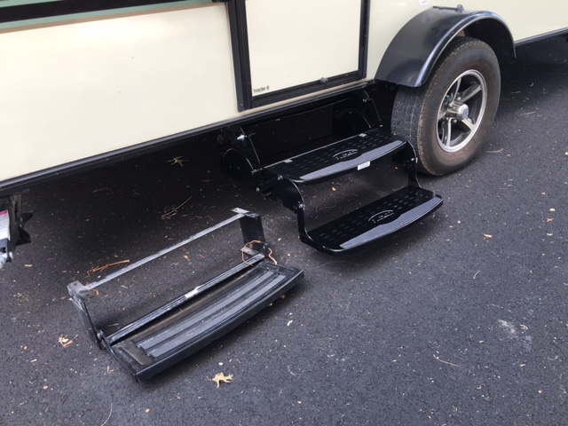

I must have had too much open on my computer at once - I finally got the photos to attach! I put the front bolts in first, so I could see where to drill. A 3/8" bit took only a few minutes for each hole - but I had to crawl around a bit to get access to one of them. Use a center punch or a nail to mark the place you want to drill, so it doesn't "drift" on you.
The new double step frame is about 2 1/2" lower than the old step frame - but no more at risk than the back stablilzer jack I think. I'm going to put a lift kit under my axle this winter - that was already my plan BEFORE I got the new steps - to keep those back jacks from dragging on steep entryways, and to protect the "underneath stuff" (tanks, tubes, pipes, and wires!) from road hazards.
