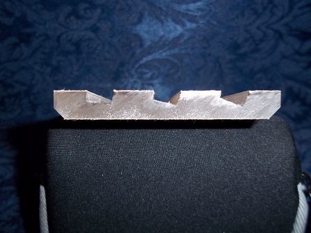

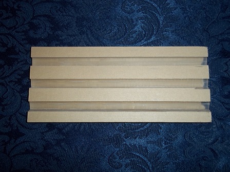

I am the source of the lightbar,I used a strip of plexiglass 64" long 2 3/4" wide and 3'8 thick. Then I cut three groves 5/16"
into it, but I didn't want lights to shine straight back, so I angled the groves 8-16 and 24 degrees put in the light strips and sealed them with silicone. The whole strip uses 24 watts.

 but I didn't want lights to shine __straight back, so I angled the groves 8-16 and 24 degrees put in the light strips and sealed them with silicone. The whole strip uses 24 watts.
As always job well done, like the lights angled down so as not to blind others.
