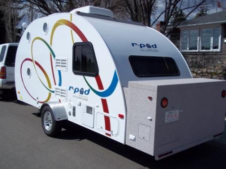

That is an extensive mod. Looks like a great job!

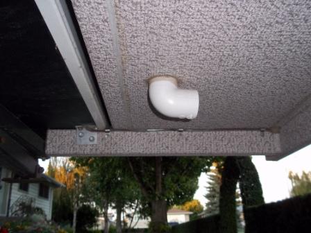

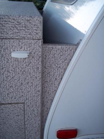

I extended the outer joist tubing by inserting a 5' piece of oak into the tubing and let it stick out 20", I also extended the spare tire hitch. Then I fit a spacer between the trailer and the box, the spacer is attached to the trailer and the box is attached to the spacer.

It looks like you are incredibly skilled at modding, but it seems like it would make the pod imbalanced. I try to keep as much cargo weight above the wheels or in front of them, and this is the exact opposite. Do you use a WDH?

Direct Link To This Post Posted: 24 Feb 2013 at 11:33am
    I really like the Hockey Puck on top of the bottle jack to raise the gen up a little.

Direct Link To This Post Posted: 27 Feb 2013 at 11:36am
This is what I was thinking... but a WDH is to take a load off the hitch and put more on the front wheels of the TV and the trailer..   Scratching my head, but it seems that the trailer would be tail heavy not hitch heavy.  Do you have sway when driving.. ?

Direct Link To This Post Posted: 27 Feb 2013 at 12:37pm
Yes I use a WDH, I would not leave home without it. I have (the original Equal-i-zer sway control hitch). No problems with any kind of swaying.

Direct Link To This Post Posted: 27 Feb 2013 at 1:41pm
I mean to say sway control, but instead I wrote WDH. Having a cargo unit this large hanging off the back would definitely lighten the tongue.

Direct Link To This Post Posted: 27 Feb 2013 at 1:42pm
I'm curious what your tongue weight ends up being. Any idea how much that cargo box weighs?
