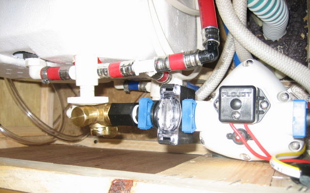

Here's a picture of the "T Valve" assembly installed.
Everything to the left of the blue slide lock came with the kit. There was a black double female ended coupling, the brass valve assembly and the chrome covered brass cap with hose (laying on the floor to the rear of the hot water heater. The round brass cap in the middle of the assembly screws off and you attached the separate cap and hose. Then you turn the 3 white factory handles 90 degrees and do the same to the little lever you see just below/in front of the removable brass cap. Then just stick the loose end of the hose into a jug of antifreeze, open open your faucets and turn on the pump until you see pink stuff coming out.
This assembly stays in place year-round and the only need to access it is to remove the cap/replace it with the cap-hose assembly and turn the valve from the "open" to the "bypass" position.
Not what I would call a "perfect solution", and honestly I believe that Forest River should have just added an assembly like this to the base plumbing near the pump - - but sometimes you just have to play the cards your dealt. It works ...and that's all I care about. I think the entire kit (Camco, ordered off of Amazon) was around $6 or $8. I ordered some other stuff and got free delivery.
