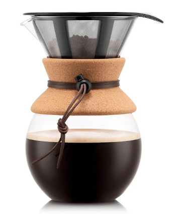

I'll suggest a better coffee maker (Bodum) and a teapot.
You might investigate a Bodum Vacuum siphon, but use a Yama filter.  These are messier to clean, though.  You can use it on your gas burner.  Superior coffee.
I use the pour over in my R-Pod for speed and convenience.
