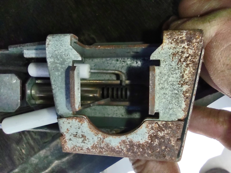

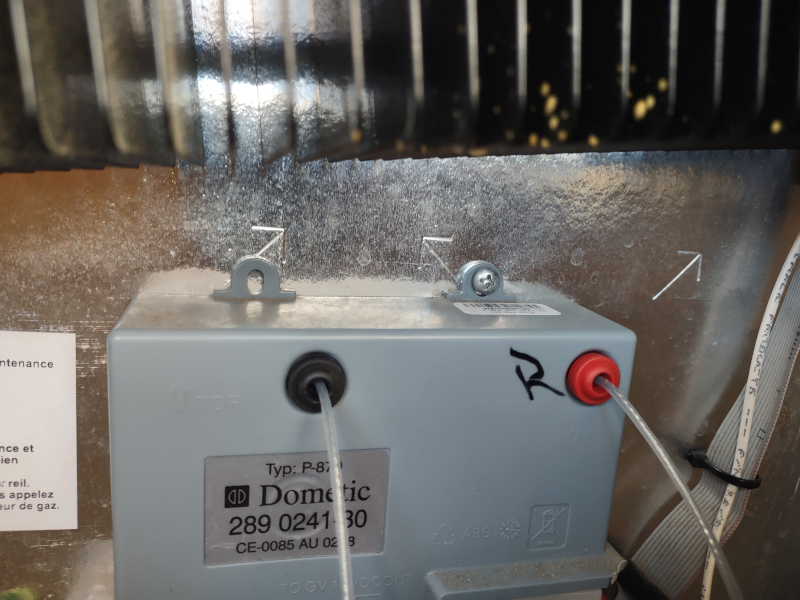

Check the picture of what it should look like. There are two wires. One is red and the other is black. The electronic box into which they plug has on it which color goes into which connection. If you unplugged them, check that also. It may not be marked. Mine was in marker. The red plug goies in the right opening and the black one plugs in to the left connector above the label.The spark electrode and the thermocouple should be at least at the edge of the burner slots, Neither should be touching the burner.
