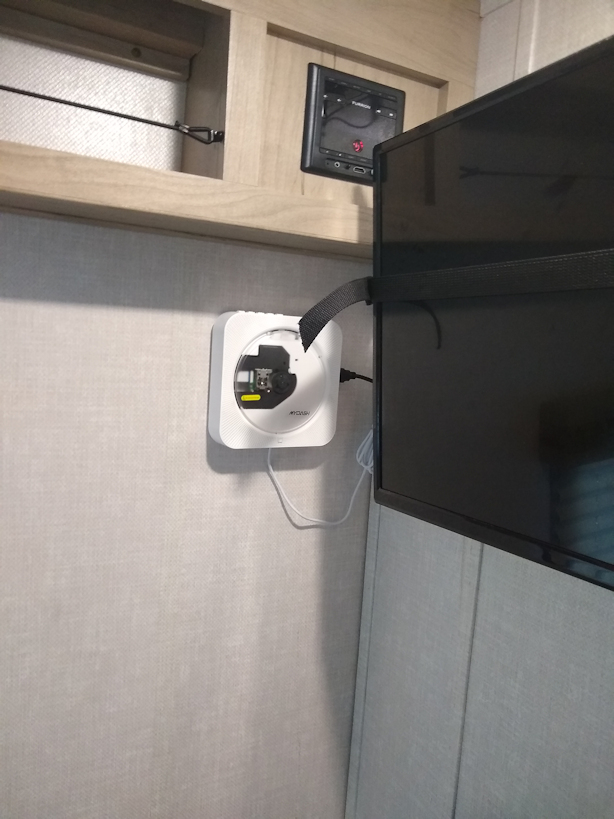

Love it! Need to add some lifts to the under bed storage lid and maybe some shelves to the bedside cabinets. I wish it had a cd/dvd player built in but I know that is so "old school".

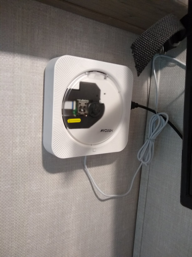

Adding a player is easy. I bought a DVD/CD player on Amazon that is powered through a USB connection - the one on the sound system control unit is able to supply the power, and that cleans up the number of cables.
The HDMI connection feeds through to the existing TV connection from the control unit, or can go directly to the TV if preferred. The one time I tried the CD player function, it played through as well. Light and easy to mount on the wall, affordably priced.

Thanks, that's what I've been looking for!
The current version of the product is on Amazon at this link:
It looks like the new version may have a slightly higher power demand, since it's supplied with a 2 amp USB power supply adapter, but there are similar units on the market.
