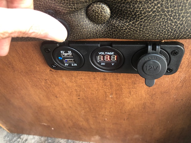

I added a LED Battery Gauge with USB and 12V lighter port to extra circuit in fuse panel, at a glance I can see battery level. Added to dinette seat, I can see from outside RV.
