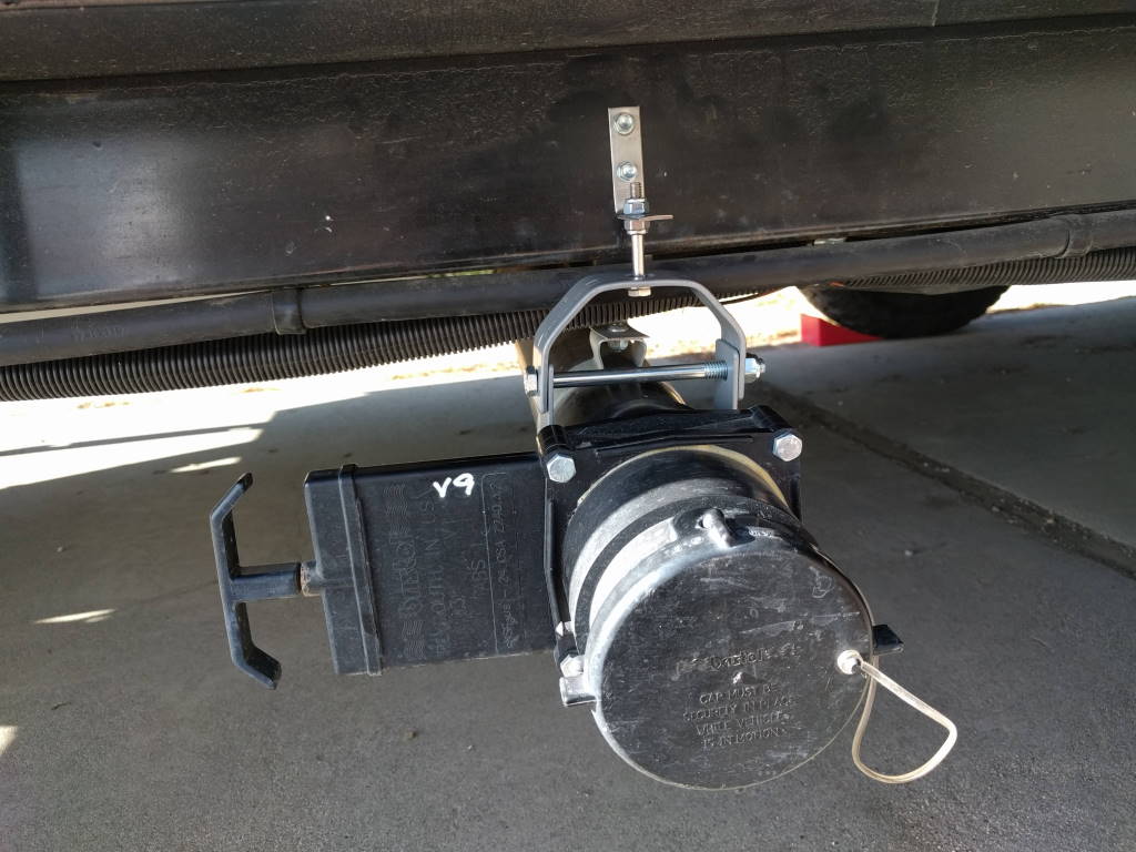

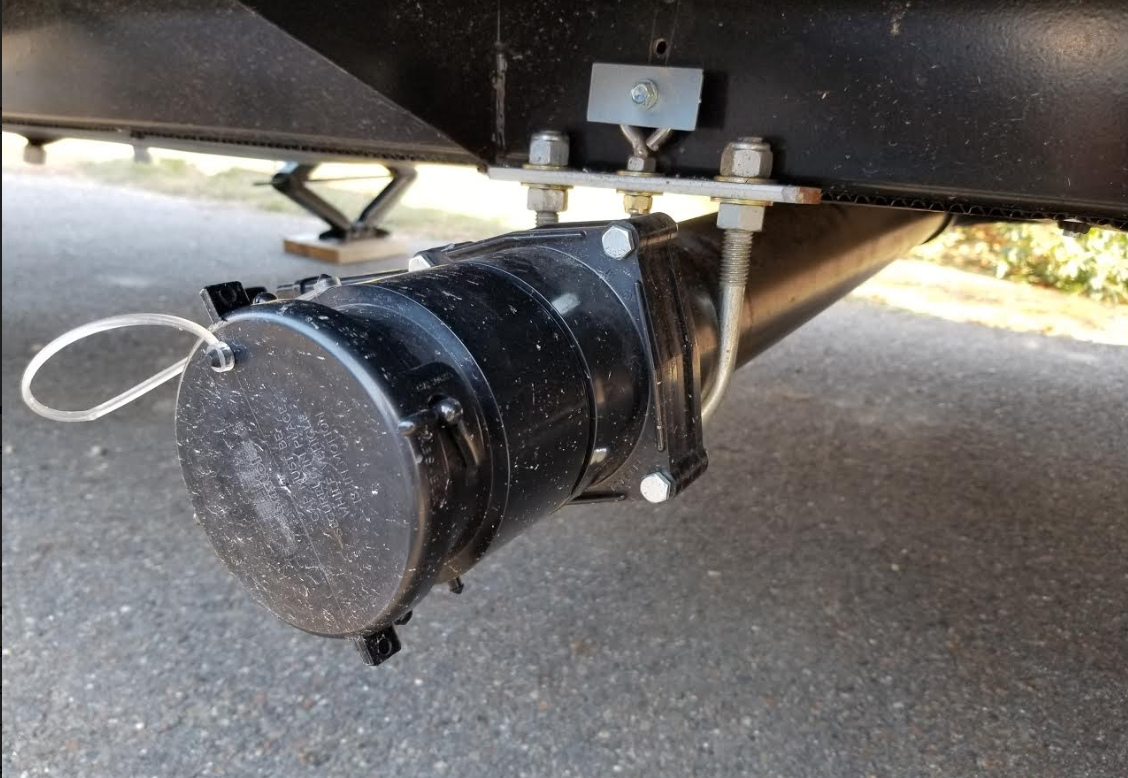

An elegant solution, TCJ - but it looks like you have additional strap support to the gray and black tank..... my 178 black discharge tube has only the strap at the end of the tube at the frame and, of course, I have separate black and gray tubes. The gray tank tube has not been a problem - it's a stout strap and doesn't seem to flex. Your solution looks like the description StephenH gave using a 1/8" alluminum strap, only your rubber belt strip would certainly support the tube end.
Still leaning toward the aluminum strap, pipe clamps and a rubber sleeve under the pipe clamp.

We installed a clevis hanger and left the original strap in place. We used a smaller hanger for the gray water drain tube.

Tks, GlueGuy - is the clevis hanger two U shapes that would allow the end of the tube to bounce up and down, with the upper limit being the bolt holding the U ends together? Or does that bolt sit right on top of the tube? I guess the assembly could move up and down on the vertical bolt holding the top U to the strap.

I would be cautious about using 6061 alum to make a hanger. Although it's pliable. it doesn't like to be bent anywhere near 90 degrees. 5052 is aluminum meant for bending to extreme angles, commonly called sheet metal. Many use muffler clamps, and they seem to work well. I made mine from parts available at the hardware store.

I doubt there is much to make the sewer pipe to go up. The clevis hanger is pretty stout material, and it makes a good cradle for the pipe to hang in. The bolt going through the top of the clevis can be tightened down somewhat, but in the end, it just makes the sewer pipe steady. I don't know how many miles we have on it at this point, but I check it periodically, and nothing is moving.

Thanks for the info on 6061 aluminum - there is a welding shop around here I can probably get to start with a 12" x 1-1/2" x 1/8" stainless steel strap and make the bends for me. I can cut it to length as needed and drill the two holes that would be needed to match the two already in the frame.

This seems to be an ongoing problem with the rpods....surprised FR hasn't done something to beef up the hanger. I put a new hanger on (OEM) today on the blackwater and added a rubber strap as back up plus it acts as a shock absorber. I had fixed the old bracket before but we took it on 2 trips and when I checked it everything was loose and failure would have been soon.
