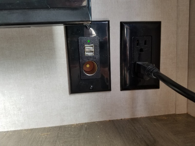

I want the inverter right where the TV is and I already have a USB charge port so it will be easy to change over to add the 12 volt recepticle. If I put it at the battery it is all the way at the front of rpod.

I got my inverter and plug unit in.  It looks like it has 16 gauge wiring.  The factory wiring for the USB plugs looks more like 18 guage.  I think I will try to run new wiring so it is 16 gauge the whole way.  How hard is it to fish a line down to the converter?
Direct Link To This Post Posted: 07 Nov 2020 at 5:58pm
16 awg is only good for 13 amps. So that's 150 watts dc, about 120 watts ac taking inverter efficiency into account. 18 is only good for 10A so 120w dc, around 100 w ac. That's a little borderline but should be enough for the TV.  I'd suggest running heavier gauge wire like maybe 12 gauge as long if you're pulling wire anyway, then you'd have better capacity if you ever needed it.  You could try using the existing 18 awg to pull the new wire back with.

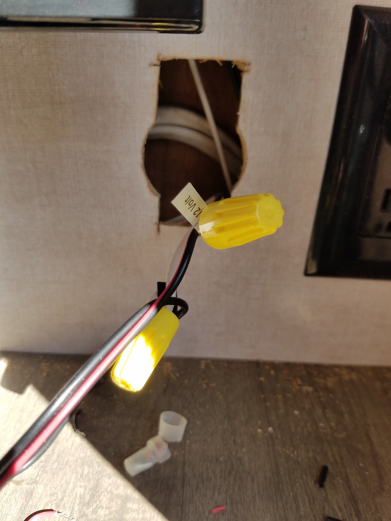

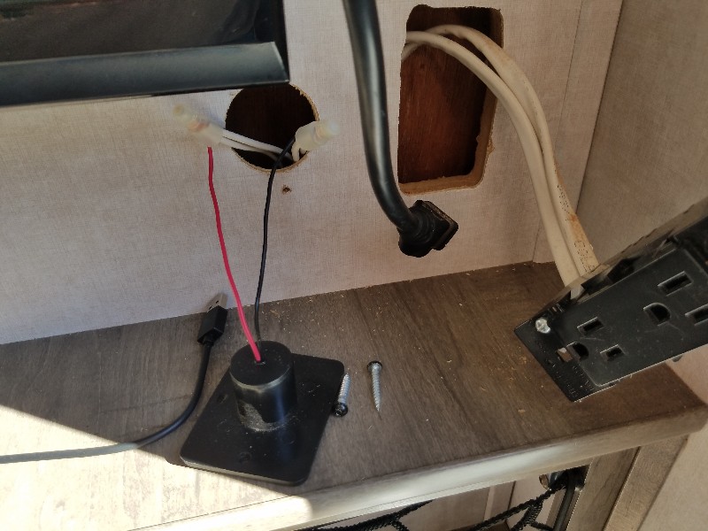

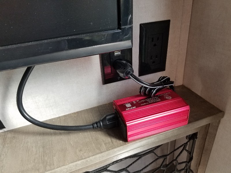

Well I got it done today.  When I pulled the wires for the old USB plug I found they were attached to some 12 guage wires.  I wired up the new usb/12volt plug unit.  I had to cut the panel a bit for it to fit...used oscillating saw made quick work of it.  Tested with the inverter and TV works fine.  I think it came out pretty nice.

Direct Link To This Post Posted: 09 Nov 2020 at 6:53pm
Looks good.
