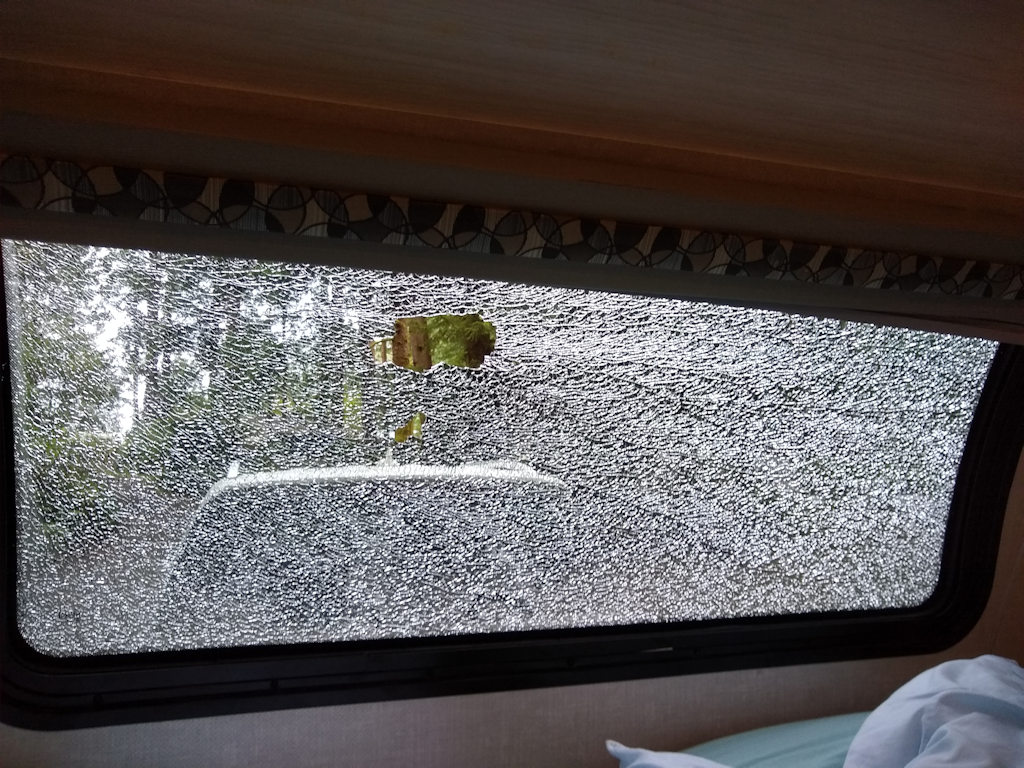

Good point. So we are needing Flipishollywood to let us know if the window he has is glass or plastic....If glass then it should be tempered and should have broken into a bazilion pieces. If plastic, its probably acrylic, polycarbonate/lexan is very difficult to break, at least not until it has been UV damaged, which takes awhile.

couldn’t get the photo to upload, so here is a link to see the broken window. it’s definitely tempered glass from what i can tell. Pic of broken rpod window

Yep, sure is tempered glass. Most likely a rock hit it, cut the surface layer and broke it. When FR says that it is like your car windshield they are misrepresenting, windshields are not made of tempered glass. They are laminated glass so they don't turn into shrapnel when a rock hits them. Your car's side windows are tempered glass, but those aren't subject to rocks striking them.
If you can't get FR or your insurance company to help then you will unfortunately will need to pay to have the window replaced yourself. Then cover it with something while driving, it will just keep happening otherwise. Maybe glue magnets to the glass to hold the cover?

I would make an attempt to find a plastic alternative. (lexan, acrylic, polycarbonate, etc)
Using a tempered piece up there, when the entire automotive world does not, seems inappropriate on the part of Forest River.

I agree that a polymer for that application would be much better.
If someone wanted to take on that challenge then polycarbonate (Lexan is a brand name of polycarbonate just like Plexiglas is a brand name of acrylic) would be the better choice. Stronger, less brittle, and you can heat form it with a heat gun if you are careful. The problem is going to be to get the shape right and get it glazed in so it doesn't leak. Getting a leak in that area could be a much worse disaster than a broken window.
Another thing that could help would be to cover the tempered glass with a clear vinyl layer. Get as thick vinyl as you can, the purpose would be to stop small rock chips from reaching the glass surface. If you ever get a big rock strike it would still break but that should be a rare event unless you're towing to Alaska or something.
You'd need to experiment a bit with clear adhesives to stick it on there, and you'd want to be able to replace it after a couple of years when the vinyl gets weathered. Or stick it on with magnets.

Many of the new camper models have these front windows so I suspect this problem will not be uncommon. Has anyone found a way to prevent this from happening?  They make "bras" for cars to prevent rocks from chipping the paint and bugs from staining it.  Do they make something similar for R-Pods and how would you secure it?
I had a Trailmanor camper once that had an aluminum cover over the front window.  But the window had an internal wooden frame that was more secure than the sandwich material used to make the new R-Pods.

My wife and I just got home from an extended trip to the Oregon coast with our 196 (2021 model, but early in the model year production with the 202 graphics). We woke one morning late in the trip and discovered that our front window was shattered - completely crazed one side to the other, top to bottom with no sign of an impact visible. It had stayed in place - at least until it was touched, at which point parts began to fall out.
The calls began.
Contacted my selling dealer, who expressed sympathy but said there was nothing they could do - that FR responded better to direct calls by customers. Contacted FR - who have, by the way, a system designed specifically to make it difficult to reach human beings directly. Eventually reached, after multiple calls, Meghan in Warranty.
I described the issue to her, indicating we were on the road, and would be leaving on another trip just a short time after our return home. I told her I knew we would have to take steps to prevent further damage while moving the trailer, whether to home or a dealer or wherever. I also told her I knew the factory was nearby, and asked her to check whether there was any way of using their resources.
As it turns out - and amazingly - Meghan arranged for the factory in Oregon to have the window replaced right away. We drove the 3 hours (5 as it turned out, due to a road closure), and the window was replaced the next day. Wonderful - and a good attitude from the staff there. Kudos on that front to them and to Meghan.
As it turns out, the replacement unit was either poorly installed or has some faults of its own - that night, we had heavy rain in the California redwood forest, and the new window leaked like crazy!
The new problem has been reported, I have done my own temporary repair on the leak issue (high quality silicone sealant, used liberally Big smile), and we will see how they handle this. Also, I would swear the interior metal frame is installed top to bottom, as there is now a seam split in the bottom that was on the top with the original.
