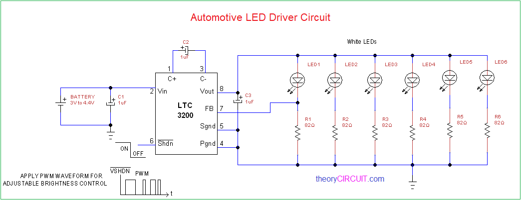

offgrid
Posted: 24 Oct 2020 at 12:59pm |
We can't know for sure but the issue was likely not the switch itself but the LED driver circuit. LEDs need that to control brightness. They do that by switching a transistor in series with the LEDs that regulates how much current flows through the LEDs. If the transistor fails shorted then the LEDs can still be connected and glow. Here's an example driver circuit:
