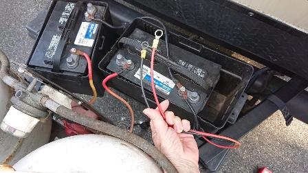

hi Folks,
My solar panel project this summer has meant I've learned a lot about my batteries but not enough yet.  These are both 12 volt (the batteries are new(er) but they replicate with came with the camper). Can someone please tell me what these two loose wires are and, as unlikely a possibility as that seems, are they supposed to be loose?
Julie

Is your solar hooked up and working? The wires resemble solar, but I can't be sure, hard to tell from a picture.

Sorry for being confusing.
No, the solar is just a suitcase portable panel. It's just that before I got that and tried boon docking I left batteries alone (was learning other things). Now I am learning batteries. But this is just the two 12 volt batteries wired in parallel (I believe). I just don't know what these "extra" wires are. Have they become disconnected from somewhere?  A ground wire maybe?

One appears to be ground and one appears to be a positive, could they be for your solar wiring at rear of trailer? Even a suitcase requires a hook point at you trailer. Are these wires attached to your solar attach point at rear of trailer? Is your electric jack working?

Mike's probably right. We have an extra pair of wires that are connected to a Z-amp connector at the other end of the trailer. We don't plan on using them, as we'll be connecting our solar directly.

Ah. I do connect the renogy solar panel to the batteries directly.  I bet one of these wires is a ground. Any idea how to tell which and what do I need to do with it?
I'm open to instruction on how I should be connecting the renogy panels. I have put them on one of the batteries matching positive and negative

Julie, you do seem to have some odd stuff going on with your batteries.
First, yes it does appear that the batteries are connected in parallel. You can tell that because there is a black jumper wire between the two negative battery posts and a red one that looks like it goes between the two positive posts.
And I see what appears to be the negative connection from the batteries going (probably) to the pod panelboard (black wire connected to the battery post just above your hand in the photo).  What I don't see is the positive connector from the batteries to the pod. That should be connected to one of the two positive battery posts (preferably to the battery on the left that the negative lead is NOT connected to, it balances the batteries better if you do that). It could be the red wire you're holding but if that's not  ever been connected then I'm puzzled how you have been getting battery power to your trailer dc circuits.
As GlueGuy says, I also have two extra wires on my trailer (smaller gauge that the main battery cables) which go to the Zamp solar port. So we have a total of 4, your picture only shows 3 wires plus the two battery jumper wires. Is there another wire somewhere that's not showing up in the picture?
Next, did you rotate the left battery around or is it always set in there on an angle like that? I notice that the right side case is bigger than that battery, I'd suggest getting the correct size for that and placing the batteries in there lengthwise so you can strap them down and everything is stable. Those plastic cases aren't expensive.
Finally, if you connect the suitcase solar kit directly to the battery, is there a fuse at the battery + terminal for that? If not, you should add one for safety. And be very careful working with wrenches and loose wires around batteries. If you've never seen what happens when you short a battery post to post or positive to frame ground you don't want to. You can get a heavy wire or tool red hot in a fraction of a second or even blow the side of a battery case off spraying acid everywhere due to internal heating.  Its best to tape up your wrench(es) so you don't accidentally touch them between posts and also disconnect the negative terminal first when working on batteries.
I see your point! But I do have battery power in the camper. Maybe it's hidden in the picture. I'll check.
I'll check
No, this is how they came to me. I like this idea.
I do always disconnect negative first and am very careful around anything electrical (dad was an electrician).  Honestly if I can find someone to look at this and straighten it our for me I'm inclined to go with (paid) expertise. I think adding a fuse might be beyond my skills at this point.  :)
