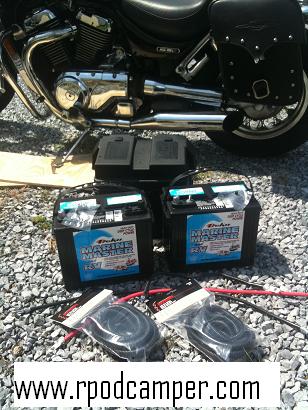

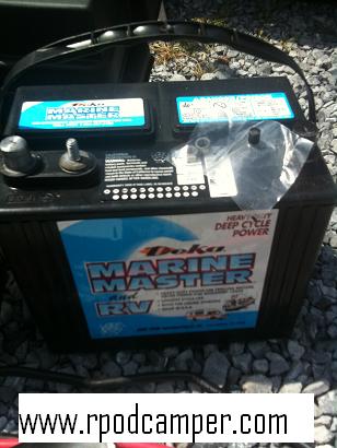

We do alot of Dry Camping and seem to run low on power, so we pulled the single battery out and bought 2 12 Volt Batteries. They are the Deka DC24 Battery. We also picked up some 4 gauge battery wires already made ane another battery box.
Our Parts:
The batteries:

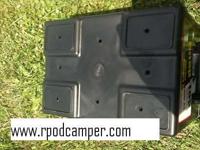

I Made sure to drill holes in the bottom of the box to allow water to drain

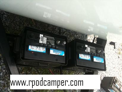

Placed the two boxes and batteries on the frame:

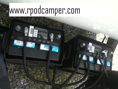

Wired the batteries in Parallel and hooked up a switch to shut off the pack:

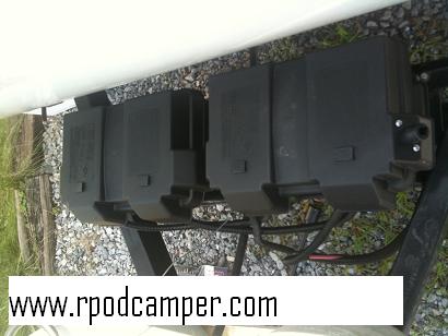

Dressed up all the wires and closed them up :
Connecting in Parallel
When
connecting in Parallel you are doubling the capacity (amp hours) of the
battery while maintaining the voltage of one of the individual
batteries. Use a jumper wire between the
positives of both batteries and another jumper wire between the
negatives of both batteries. Connect your positive and negative wires to
the same battery to run to your application.
