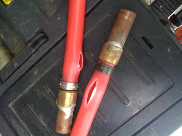

But.. I have had my low points freeze solid down to 0F with pure water in them, and it didn't hurt them. We don't winterize to protect the lines. The lines and "plumbing" are PEX, and PEX rated, so freezing literally cannot hurt them.
While its much less likely to damage pex rubing from freezing than for example Cu pipe, it is certainly possible.
Bursting becomes more likely over time as the plastic ages and becomes more brittle, like all plastics do.
I researched this when I replaced all the plumbing in my house with pex 3 years ago. We all have hose lines exposed to freezing under our elevated houses here. I drain those in the winter. I love pex but I'm not confident to leave plain water in the exposed low point drain lines in my pod.
The other problem with pex is that it is damaged by UV exposure, so should never be left exposed to sunlight for long periods. Some of the longer low point drains hang down enough to get sun exposure at times.
Personally, I think the best approach is just to remove the low point drains entirely. They aren't really needed for freeze proofing with either air or antifreeze and provide a place where the rPod plumbing is exposed to freezing, UV, and physical damage.
Direct Link To This Post Posted: 20 Feb 2019 at 6:46pm
Originally posted by offgrid
You are correct, in just the right conditions, PEX can rupture. It's usually line pressure, but again, in just the right conditions, freezing has done it.
I try to never talk in absolutes, and I did here. Sorry.
In MY PERSONAL EXPERIENCE, dealing directly with hundreds, if not thousands of Podders, 'streamers, and Lancers at this point, I have neither trouble shot or repaired a PEX line in a camper that had burst from freezing, and I don't recall anyone having it happen.

Direct Link To This Post Posted: 21 Feb 2019 at 6:14am
Agreed, I haven't heard of in RV's it either. In residential use it seems like it tends to occur when an ice plug forms in the line and then the water between the ice plug and a fixture freezes and has nowhere to expand to.  I suspect it will get more common as pex ages. It has a stated life expectancy of 40-50 years if not exposed to UV.  Pex first came into use in plumbing about 20-25 years ago.
My conclusion is that if you use the low point drains as intended then there is no freezing risk from them, there will either be air or antifreeze in them. If you don't use them then why not remove them, or as much of them as possible? If you do keep them then protect them (with pipe insulation or some other material) from UV and flying rocks, especially if they hang down about a foot like mine did. That seems ridiculous to me.
