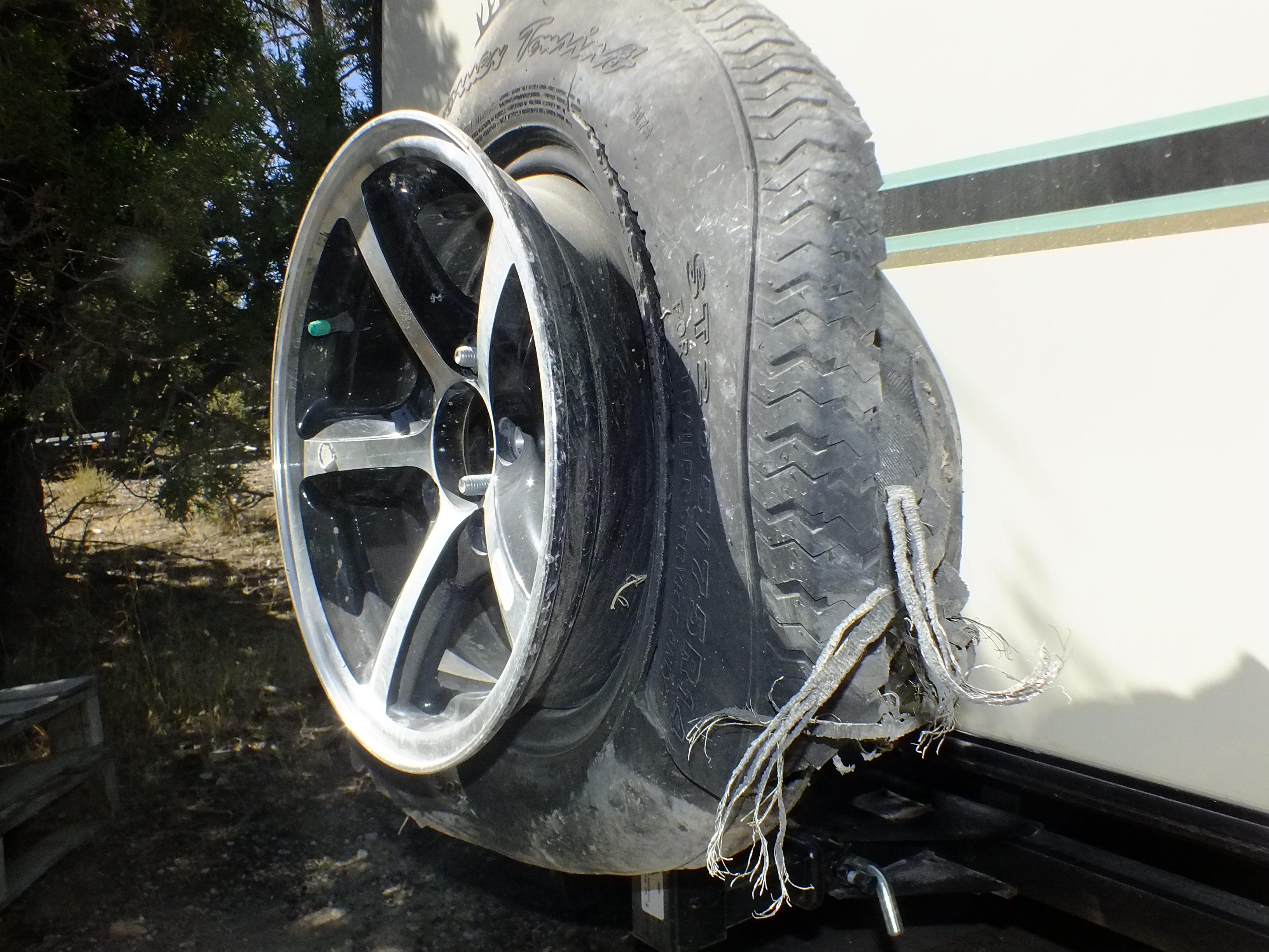

We had a blowout on our 4th trip with our Rpod (2016 we bought this year).  I was towing with a 2015 Nissan Xterra with friction sway control - not a very big vehicle.
We were doing 65 mph on US-93 west of Great Basin Nat'l Park.  Air temps prob about 25C or 80F - not too hot.  Tires were the Ridgway Sport 14-inch stock tires, load range C, speed rating L (75 mph), 50 psi.  Our 180 was lightly loaded, nothing in the tanks.
Suddenly there was an explosion and debris flying in front of us.  The left trailer tire had exploded.  I felt a slight pull to the left and I counter-steered to the right.  It was a two-lane hwy and a minivan was headed toward me, but I didn't have any problem staying in my lane.  I gradually slowed down and pulled on to the shoulder.
The tire was destroyed, the fender and marker lights blown off, and my brake line was taken out.
I thought it would be a lot more violent, but it just felt like a wind shake.  Maybe it was because of the anti-sway, but it was very controllable.  My tow vehicle isn't big enough to resist a lot of side-to-wide sway by itself.
Not a huge deal, but not to say I want to experience another, though.  Ouch
Tire damage
Jim
Virginia City, Nevada
2016 R-pod 180
2015 Nissan Xterra Pro-4X

Your tire might be a little worse than mine.  My brake line is still okay.  I forgot to mention I have a Fastway E2 6k WDH with sway control.  I'm sure that was a big help in my case.
