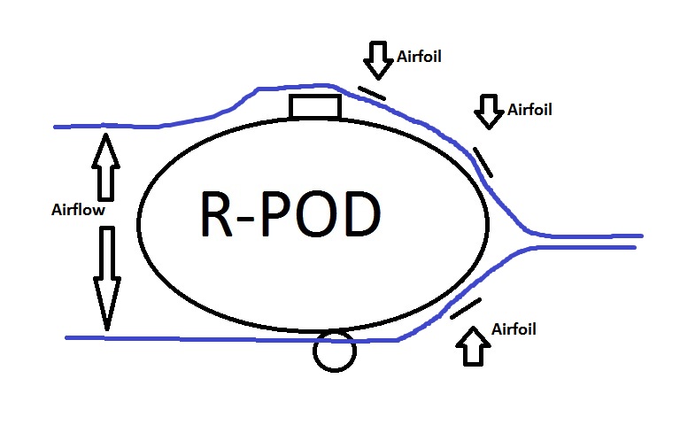

In one of the early posts in this thread, someone suggested an airfoil that would direct the air down along the back of the rpod, filling the vacume, instead of trying to send the air up over top.
Boat tailing may do more for the R-Pod than a spoiler.
Is that a simulation you could run on the software?

When I ran the aerodynamic simulations (does someone have the 'thread address' for these?)...I also ran several for aerfoils placed as per Xpod's sketch.  There was not a lot of difference in the airflow with no foil, hi foil, low foil.  What made a big difference was the distance between the TV and the Pod.  The longer the gap...the more turbulence.  I also modified the Pod shape from teardrop to rectangular 'breadbox' shape.  There was a noticeable improvement with the rectangular shape.  The 'squared' off back did not make much difference...but the 'squared' off front
did smooth the flow much more than the Pod shape.  The curved front of the Pod created a large open air pocket with large turbulence, whereas the squared off front cut the open space and turbulence.
