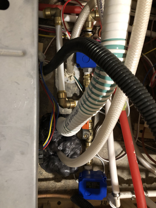

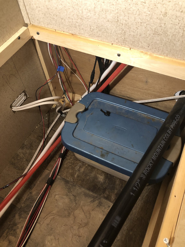

this the farthest point in the plumbing from the water heater and pump. This is the tremendous wasted space in the 182g that is between the bathroom and the rear kitchen and underneath the bottom bunk. only accessible by lifting the mattress.
This is where the second normally closed valve will go that will be controlled by the thermostat that is sensing temps close to zero to actuate and open. i store my manuals in the box in the pic here.

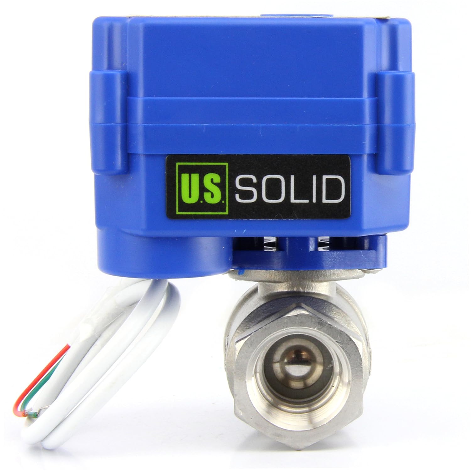

Texman, great progress. Are the two identical valves solenoid valves? Can you share a link to those?

The two identical valves are automatic ball valves that are normally closed. 30ma draw each to hold open then close on no power.

another pic of the test fit.

Thanks, good find. I think I'll probably just get a single nc ball valve as I no longer mix my cold and hot water anyhow.
