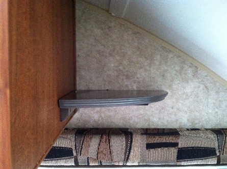

didn't want a big shelf over the bed in rpod 180, but needed something to place small items on - here is an alternative (bought it from target)
