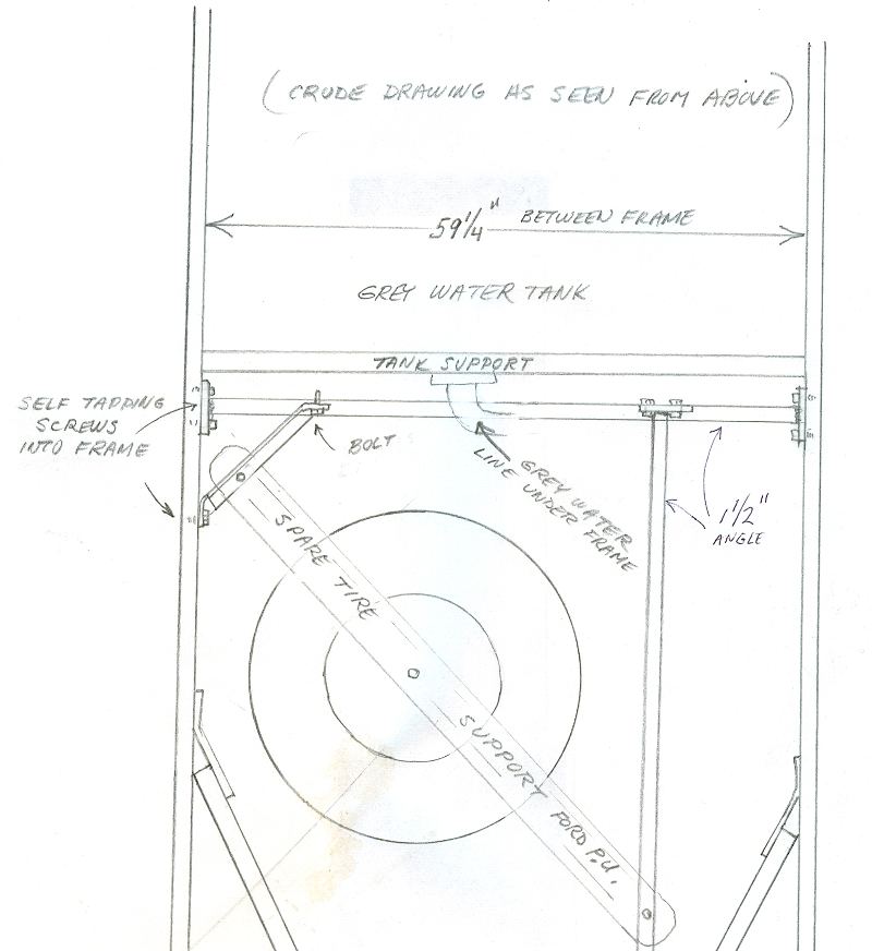

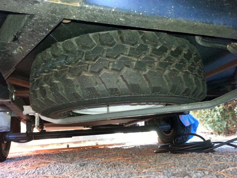

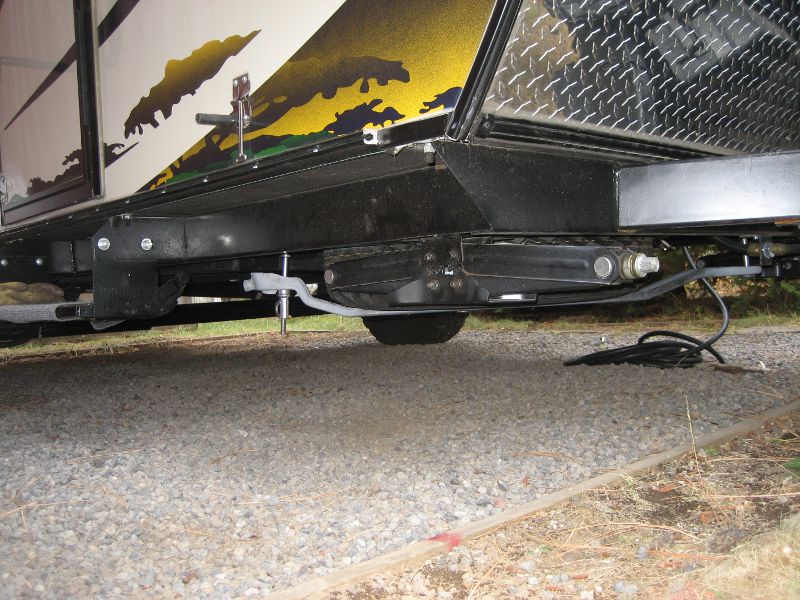

We have a 175 and installed a bicycle rack on the receiver. I built a frame to hold the spare under the front of the trailer using an old Ford under-the-bed spare support I got at a wrecking yard for $5. I used 1 1/2 inch angle steel to build a frame to hold the spare support. Worked out fine and the spare is out of sight.Tire_hanger.jpgSpare_Under_1.jpgTire_hanger_2.JPG

That is a sweet setup, nice work Serendipity!
