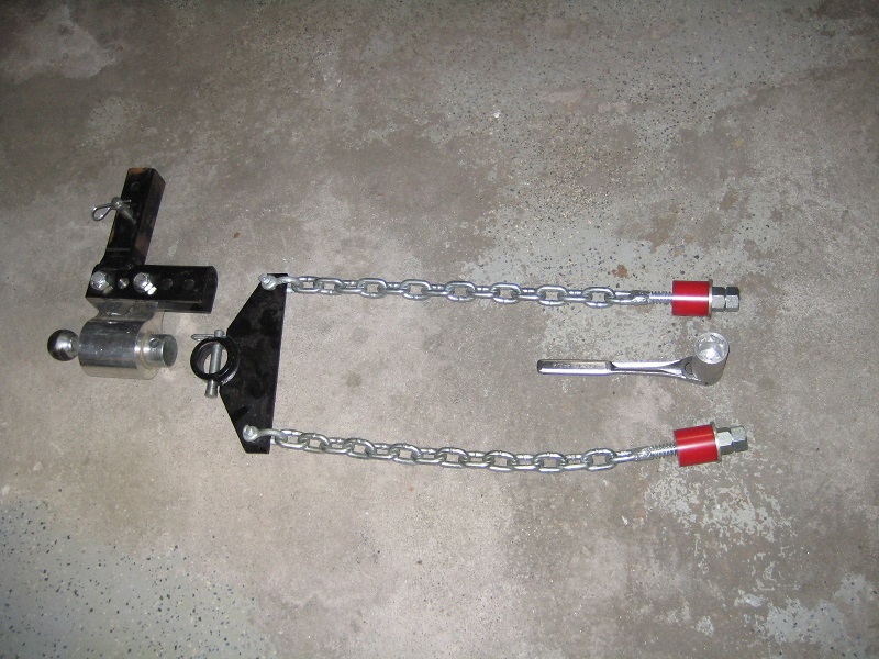

 I have had mine since Summer 2015. It works well, no sway, and NO porpoising-bounciness. Very
 smooth ride.

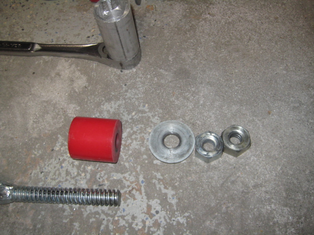

It doesn't use tension springs like traditional WD hitches. Instead it uses a Urethane Bumper "spring". The amount of tension is fully adjustable to get the trailer level regardless of tongue weight.
BEWARE the YouTube video showing how "easy" and "quick" the installation is.  It does take an hour, maybe two, to install on the R-Pod. I had to shorten the chain links using a fiberglass reinforced cut off wheel, and also had to remove and relocate the trailer break-away switch so I could mount the WD hitch on the A-Frame.
 My latest addition has been the purchase of two new chain tension nuts ($30). The hitch came with two, and after adjusting the trailer level, I found that after 100 miles or so of driving, the 2 nuts would back off, and I would start to get a bit of bounciness and tow ball creaking noise similar to not having the WD active at all.  It went this way for about 5 trips last year.
 I carry the included giant nut socket with me and a 1/2 inch drive socket wrench and re-tighten and everything is OK again. But now I am going to add the extra two nuts as jam nuts, two on each link to keep them from undoing.
 The hitch can be removed and installed without disconnecting the chains, but you must be able to jack the trailer and tow vehicle up to create slack in the chains to take the triangle plate collar on/off the tow ball mount. That's why I added an electric tongue jack.  My first test using the new improved system will be this September, 22-25, in Vermont for mountain biking.
