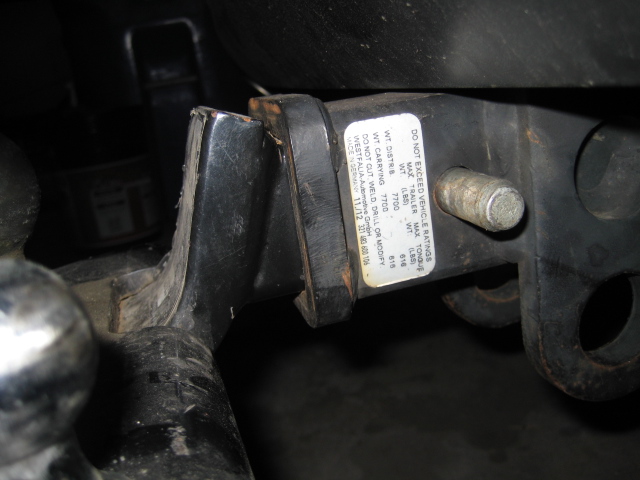

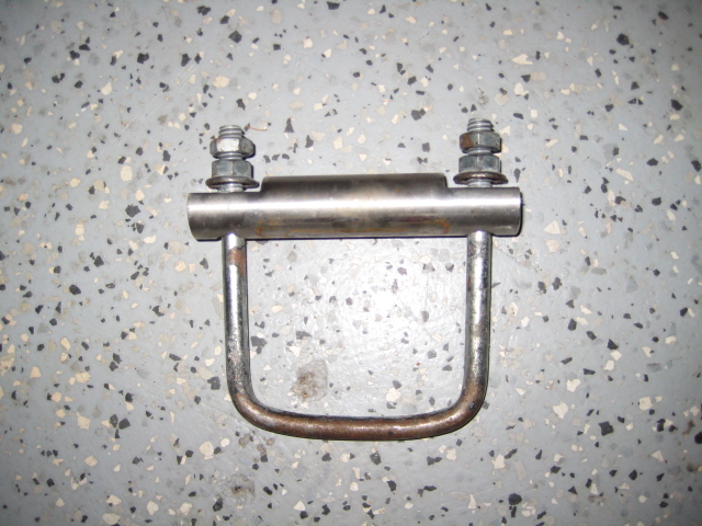

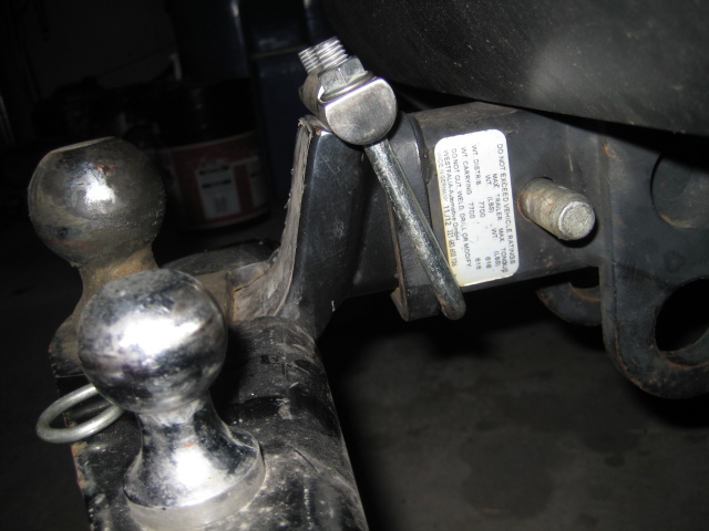

This could be the tow bar has play in the vehicle hitch receiver. Until I installed a clunk stopper on my receiver, it would knock on bumps and turns.
Shown is the anti-rattle shackle ($20), and my old tow bar (I currently use an Anderson tow bar, but I still do use the anti-rattle shackle.).
