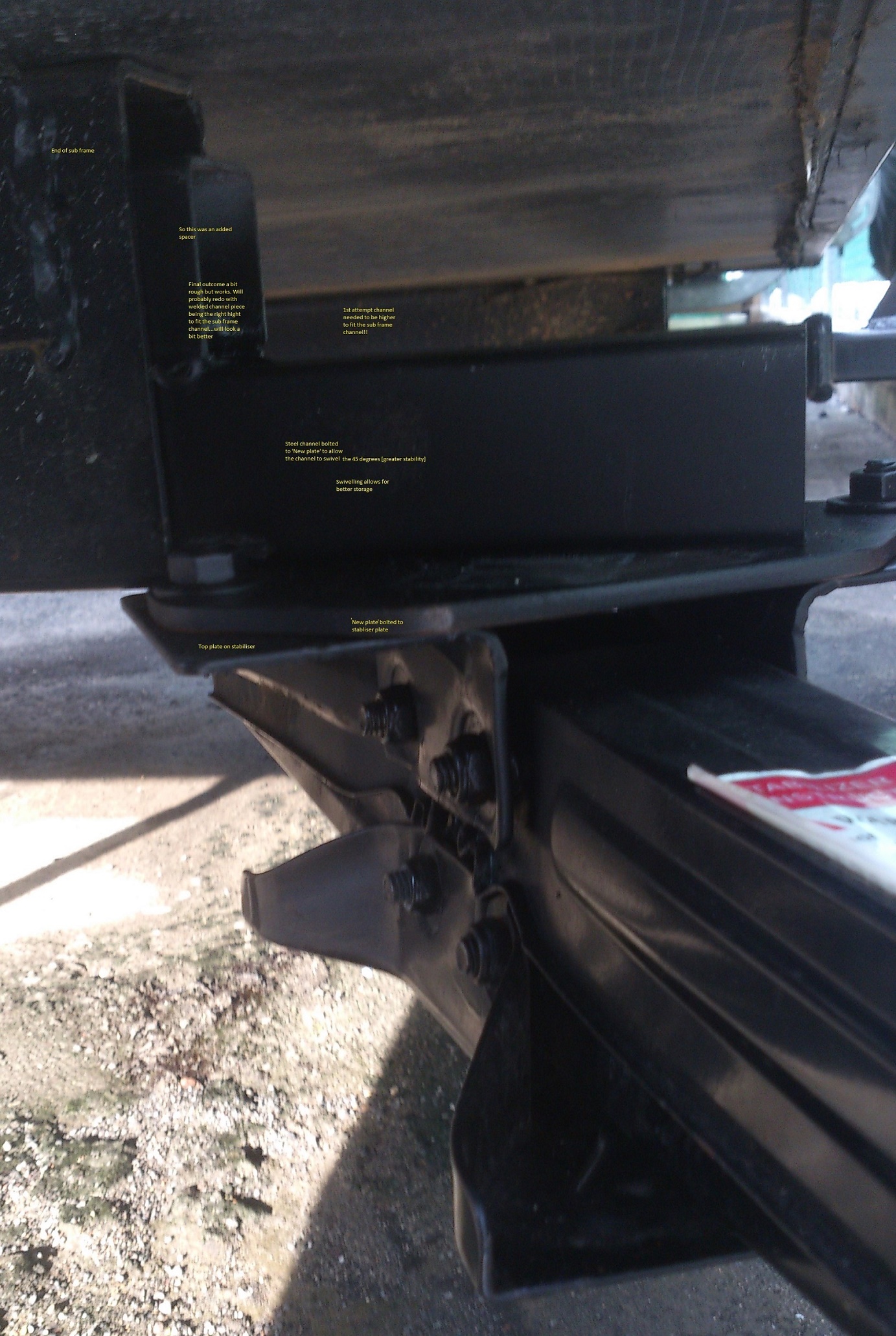

Direct Link To This Post Posted: 25 May 2016 at 1:32am
We bent one of our rear stablisers entering a garage, then bent other on a bit of a rise off road. Thought about it and have removed them [4 screws] then had bolted a square bar to stabliser plate [so it swivels to aid storage]. The bar then fits into chassis and works a treat and gives us an extra 12cm clearence

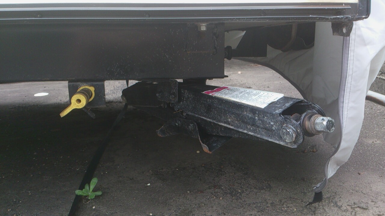

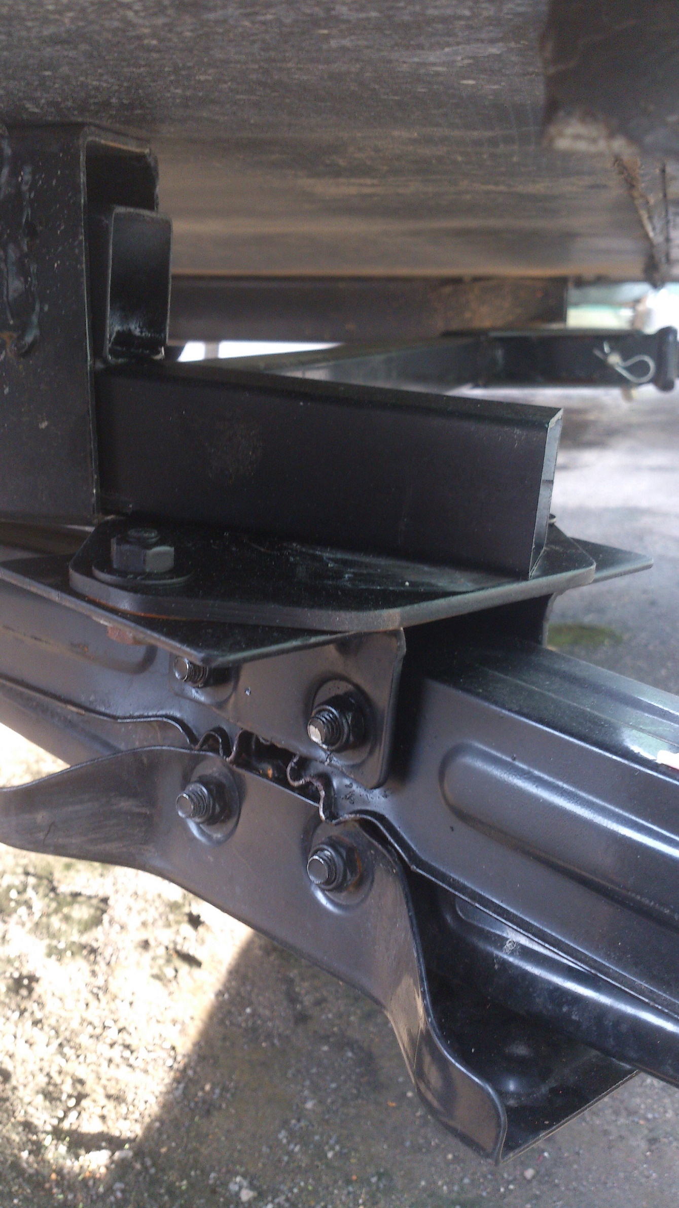

Direct Link To This Post Posted: 29 May 2016 at 1:45am
OK uploading a couple of images of the stabliser mod. It is the 1st iteration and I will probably redo so it 'looks' a bit more professional Embarrassed
1st image is jammed stabliser, 2nd image is a modded view, 3rd image has explanations. I have made the images a large as poss so you can see detail

Direct Link To This Post Posted: 29 May 2016 at 9:31am
Thank you. We have not had a problem so far, but I like the idea of being able to swivel the jacks instead of having them at a fixed angle. That alone would make this a good mod.

Direct Link To This Post Posted: 29 May 2016 at 9:55pm
we have used them for 3 setups so far and they appear to work well. The extra clearance is great Thumbs Up
