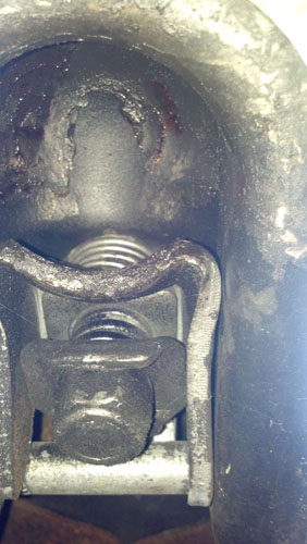

funks ![]() Groupie ![]() Joined: 05 Nov 2014 Location: CALIF Online Status: Offline Posts: 98 |
underside of hitch on my 179
underside of hitch on 179
samiam2 ![]() Newbie ![]() ![]() Joined: 16 Oct 2014 Location: Texas Online Status: Offline Posts: 23 |
Funks,
I wish my underside of my hitch looked that nice. "IF" you ball does not fit properly in coupler or tab's on bottom of latch that goes around the ball is broken off, you have a bad hitch. "IF" your trailer comes off ball easy when latched/locked down properly it's bad. My trailer has come off more than once! My trailer comes off the ball with the littlest bump going down the road. Bottom tab on latch that goes around ball is broken off. My screw is bent. I have to stand on my latch to get it to go down to latch around the ball. I've got a damaged, untowable trailer and truck bumper. I'm a weld inspector. Who to contact: National Highway Traffic Safety Administration. ![]() Send them an email with pictures and information about your hitch if you are having problems. It's a public safety issue. I posted a picture of an "NEW" trailer on a dealership lot with a damaged hitch.
