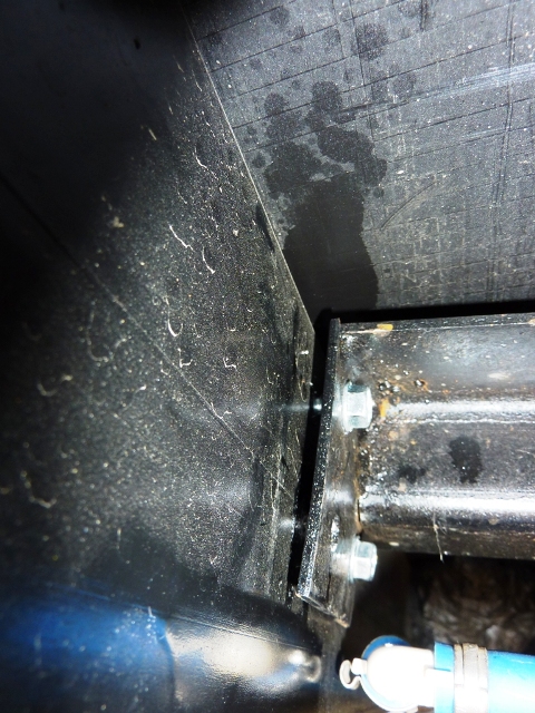

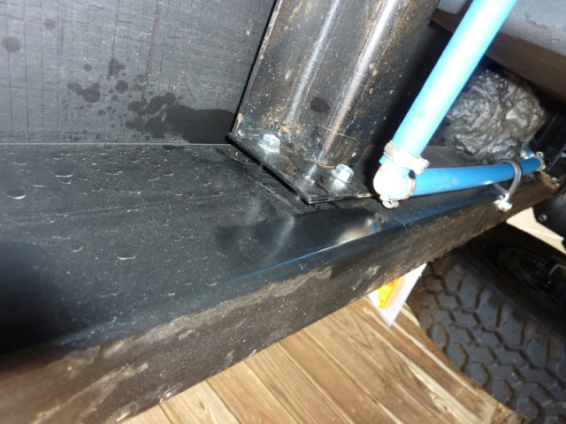

I must let you all know of an unfortunate break down of our 2014 182.  We went camping for two nights at Leo Carrillo State Beach in CA a few weekends ago and all was good until we headed home.  This campground is only an hour from our house.  About 1/2 way home I heard a scraping noise coming from the trailer so I pulled over.  One of the two metal cross beams that support the fresh water tank snapped off on one side and was dragging on the ground.  The water tank was about 3" from hitting the ground.  Since our trailer is covered by Coach Net for the first Year I gave them a call and they sent out a trailer repair company (took 5 hours to get this all done).  Before he arrived to reattach the beam I crawled under the trailer to see what really happened - I couldn't believe my eyes!  This beam is mounted to the frame by only two very small screws.  The screws snapped in 1/2.  The tank was only half full of water so I would have never expected this.  The repair man also could not believe how this beam could only have two small screws holding up the tank and we all know how heavy water is.  He reattached the beam with 3 much stronger bolts on both sides of the beam.  Now I think a may do this to the other beam on the other side of the tank.  I bet the black and grey water tank is the same way.

Good tip-  I had noticed awhile back  crawling around under mine only 2 screws on each end, not only that but the angle used to support the tank is too short so the end plates welded on are off the frame about 1/4" on mine.  That can contribute to the screws breaking....
Now just imagine the black tank dropping down and getting punctured or scraped through on the roadDead

Back in 99 or so my Tahoe toy hauler severely bent the thin sheet metal angle supports holding the 4 tanks*.  I replaced them all with actual angle iron that was much stouter.  Went from something like 1.5" angle that was 1/16 thick to 2" angle 3/16 thick.  Problem solved.

Thanks for this post.  I checked under my 179 and found the same thing for all three tanks. Each tank had two beams with one beam being welded in place and the other bolted in place so it can be removed to replace/remove the tank.  Although each bracket had three holes drilled only two sheet metal screws were used on each to attach it to the trailer frame.  My biggest concern was on one end of the black tank were there was a noticeable gap between the bracket and the trailer frame (~1/4"). This would make it even more likely for these bolts to shear or pull out.  I ended up adding a third 1/4" diameter screw to all except one end of the fresh water tank where I could not get access.

Nightmare scenario!  Looked under my 181 this morning and saw the same thing.  I wasn't too worried about the black or gray tanks, they are always empty when I pull out from anywhere, camping or home.  But I didn't like traveling with even 10 gallons in the fresh tank with out a better attachment.  This morning I drilled through the frame and installed a 2 3/4" X 5/16" bolt and ny-lock nut in the 2 empty holes.  I feel more secure now.
