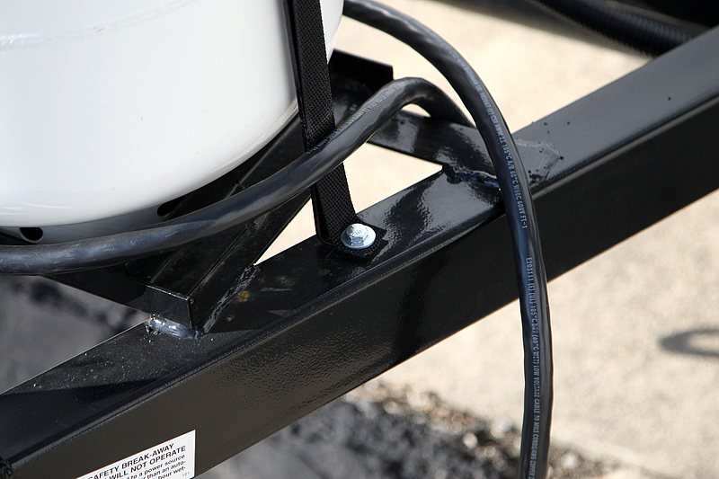

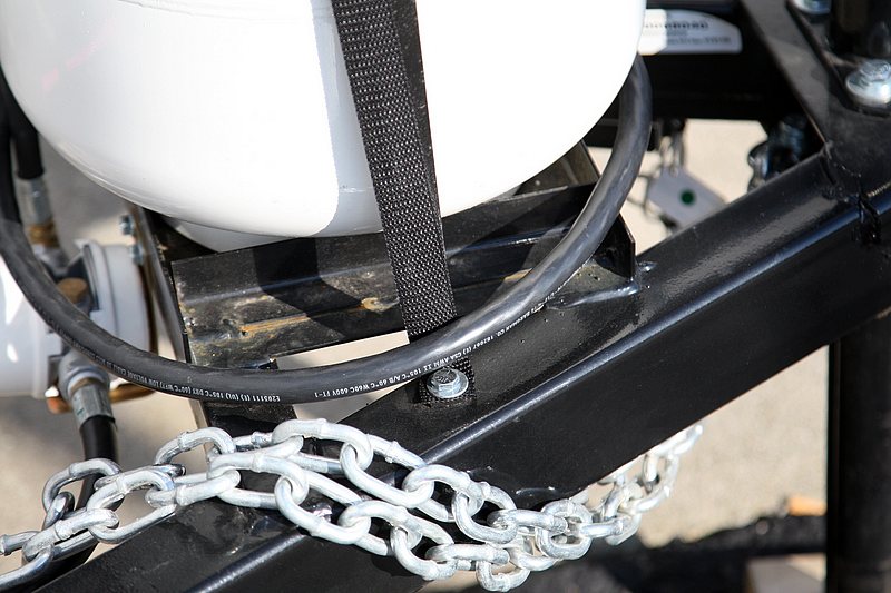

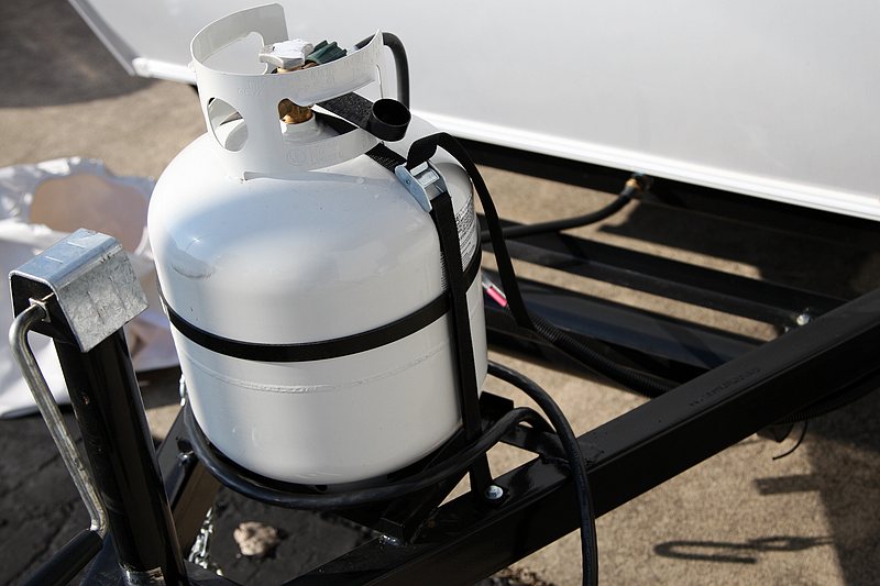

Here are photos of the recall installed...

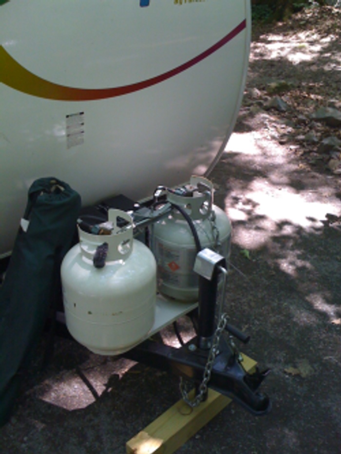

On the 171 I have ordered (Due to pickup at the end of the month) I'm having the dealer remove the single holder and they are installing a Dual Propane Holder for me.  They are also putting on a regulator that will control both bottles and I will be able to use 20 or 30 LB bottles.  The strap across the bottle IMHO just looks cheap.  Plus over time will dry rot and snap.
Direct Link To This Post Posted: 09 Jul 2009 at 11:12pm
Here is a pic of what we did with the tanks.

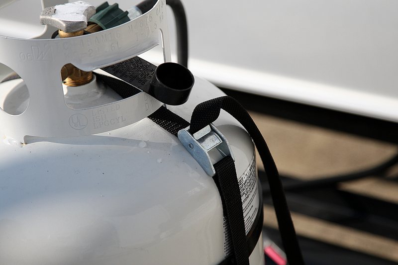

Our dealer put the strap over the vinyl cover of the single tank.  I wonder if I should put it over the tank instead, like above?

Direct Link To This Post Posted: 13 Jul 2009 at 1:11pm
Yes, the service bulletin calls for it to go over the tank directly.
