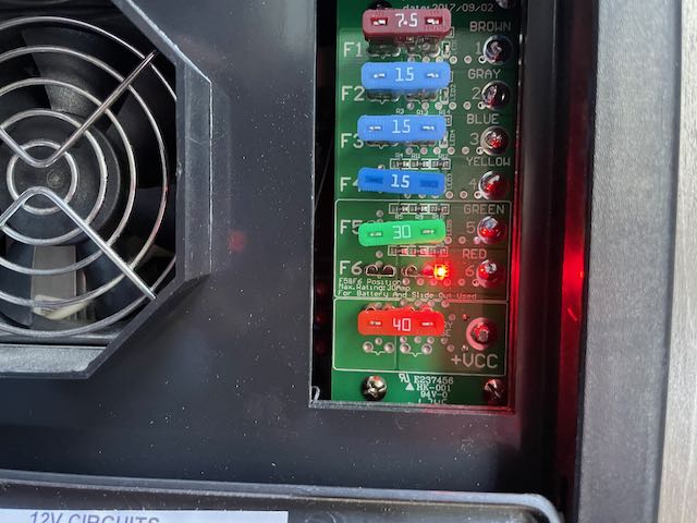

I have a 2019 Rpod 191 purchased last year & used all season with no issues. I live in the Chicago area and store it at an outdoor storage facility. The battery was bad & I removed it for storage. Recently, I installed a new, fully charged Renology AGM battery. After installing, I attempted to operate & extend the slide out, but it was dead. I checked the fuses & found a blown 30Amp fuse in the #6 location. It also had a lit Red LED. When I attempted installing a new fuse it arc'd & I did NOT attempt to secure it in place. I assume I have a short somewhere to ground?
And suggestions on diagnosing this failure? Or, does anyone have suggestions on common causes of this type of failure?

The red light means there is a working circuit but the fuse is blown. If there is a current draw, there might be a spark when the fuse legs make contact. That does not necessarily mean there is a short. What would indicate a short is if the fuse you were trying to insert blew when it had that spark. If it does not blow, then try the slide-out. If it blows then, you definitely have an issue to be checked out, but it still is not necessarily a short. It could be an overload.
As it is, the glowing LED is on the F6 position. Did you park the 30A fuse in the F5 position?

The LED will remain on until the fuse is correctly installed.  So are you saying that when you attempted to install a new fuse it shorted out or did it simply arc?   I have replaced fuses in the past and it will arc if there is any draw on that circuit but once it is installed the light will turn off.

Thanks for your reply. I will disconnect battery, install new fuse & attach battery & see if it blows immediately or when I attempt to operate the slide out switch. The arcing was a concern since this is for the slide out, and since I wasnt operating it at the time of fuse install, there shouldn't have been any current draw. So, I was concerned about the arcing.

thanks for your reply. I didnt get the fuse seated. When I saw the arcing, I assumed I have a bigger issue. I cant think of any reason there would be a current draw on this circuit if the slide out switch isn't being operated. I will try again next week when I get to the storage facility.

There is always some current flowing to that circuit through the LED, which is why the LED can light. It just is a very low current, insufficient to do more than light the LED to let you know the fuse is blown. When you put the fuse in, there will be a little spark, not a big arc (that makes it sound like a welder) and the LED will go out since there is a lower resistance path for the current to travel. Just to be sure, I went out and pulled the fuse for my slide-out, and the LED lit. When I put the fuse back in, there was a little spark until I got the blades in place to push in and seat it properly.

All fixed..I am very embarrassed, as I had battery leads reversed. Ive never done this in my life!!!
