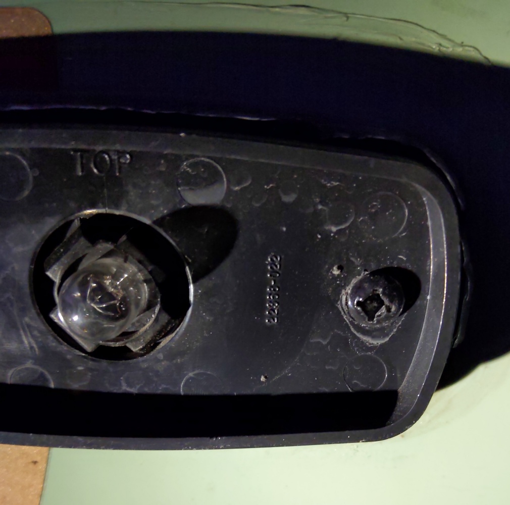

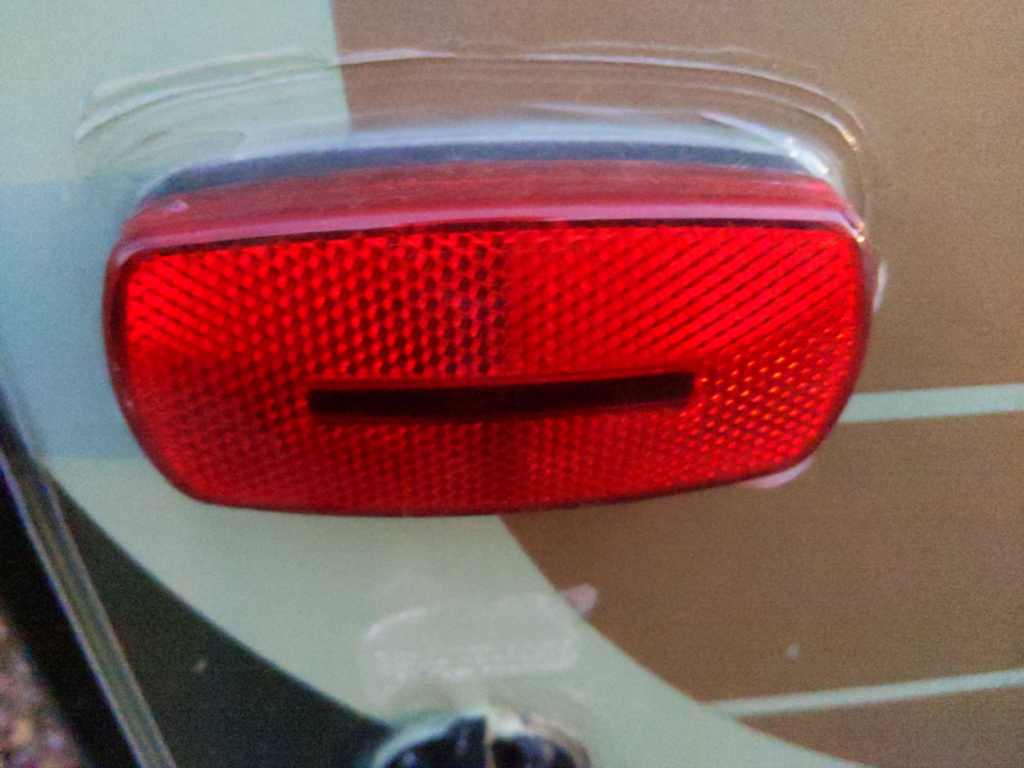

I broke one of my marker light lenses (red).  I bought a replacement from a local, handy RV place that didn't quite fit right, but was so close I thought it would stay.  Somewhere between home and Mayfield, KY it fell off.  Where can I get the correct replacement lense?

Is the one you need on the side or the one on your fender?  If you can tell me the series # on the metal bracket I will get the part # from the RV parts and accessories book.

Post Options Post Options   Quote Colt Quote  Post ReplyReply Direct Link To This Post Posted: 15 Feb 2022 at 1:28pm
I found a number in the housing, 22366-122.

Post Options Post Options   Quote jato Quote  Post ReplyReply Direct Link To This Post Posted: 15 Feb 2022 at 5:13pm
The book describes this as a waterproof LED 4" x 2" marker light.  The red replacement lens is # 681-DG52717VP.  The amber replacement lens is # 681-DG5 2716VP.  They are $ 3.49 each.  This is from the 2021 RV parts and accessories catalogue.  A local RV store or internet search should easily be able to get this.

Post Options Post Options   Quote Colt Quote  Post ReplyReply Direct Link To This Post Posted: 17 Feb 2022 at 11:45am
I found some online. Thanks! Before order, I'll go by my local RV store to see if they can get it! I didn't see the number and we had trouble matching the broken pieces.

Post Options Post Options   Quote jato Quote  Post ReplyReply Direct Link To This Post Posted: 17 Feb 2022 at 1:32pm
Worst case scenerio is if they cannot match a lens and you opt not to order the above part number you can get the whole unit (base, lens, and wiring) that would match for about $ 5 - $8.

Post Options Post Options   Quote Colt Quote  Post ReplyReply Direct Link To This Post Posted: 25 Feb 2022 at 10:34pm
Well, I had to buy the whole light, but the lens fits the original light pretty well, so I'll see how it holds up.

Post Options Post Options   Quote jato Quote  Post ReplyReply Direct Link To This Post Posted: 26 Feb 2022 at 7:36am
If it isn't a tight fit replace the whole unit.  Only 2 screws, pull it out, undo the wire nuts, replace with your new one, shouldn't take more than 5 - 10 minutes.
