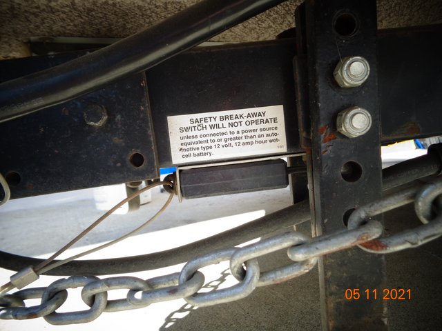

Recently purchased a 2013 171. I towed the Pod home from the previous Owner with no problems. Being new to trailers, I watched the previous Owner hook up the trailer to my vehicle. Only after I got home did I realize that there was no breakaway hooked to the vehicle. So I took a closer look. There is no plug in the break away! Looking under the Pod and following the wires, it definitely doesn't look right. The wheels do obviously turn as I had no problems towing.
I'm trying to find a photo of how the wiring should look. Wondering if someone could share a couple photos of the wiring (or provide a resource link).

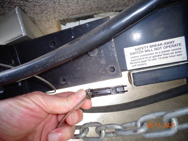

Sounds like maybe the breakaway plug got pulled out and someone dragged the trailer with the brakes engaged. Are the drums hot after you tow? Do they stop the rig when you manually engage your brake controller?
Either way I'd suggest pulling the wheels and doing a brake inspection. You have an older trailer so it needs to be done anyway. Repack the bearings while you're in there.

Thanks Marwayne!  Would you be able to post a picture of where those wires go to? (under the trailer).  It's this part that doesn't look right. If I'm tracing the wires correctly, they both connect to the same terminal..... that can't be right!

When you pull out the little pug it will activate the brakes when your trailer gets disconnected while driving. There is a cable that is attached to the plug the other side of the cable is attached to the TV just a little tighter then the brake away chains.

Fast forward to today. With your input etc, I had a new breakaway controller in my hand, ready to install. I decided to try the pin first. As soon as I put it in I heard the whole trailer release.....  Got my neighbour out to listen as i tried with and without the pin. Yup. Brakes were ON the entire 5 hour journey home. Not enough to lock them up fully.  Just enough to cause me a near heart attack.

Wow interesting story. And an interesting tow vehicle. Just a dumb question, you do have a brake controller in the Tesla, right?
Many (most?) Of us find the rpod brakes will not lock up the wheels even with full brake controller output. But they should stop the rig from 15-20 mph in a flat parking lot without using the tow vehicle brakes
If they were dragging for hours the shoes should be replaced and the drums turned or replaced. The bearings most likely overheated too. You can get full kits (brake assemblies, drums, and bearings) and just replace everything from the axle out. That's what I did. Not very expensive and less labor. Also. If the pin is pulled the brakes will draw current from the rpod battery so check the status of that as well.
